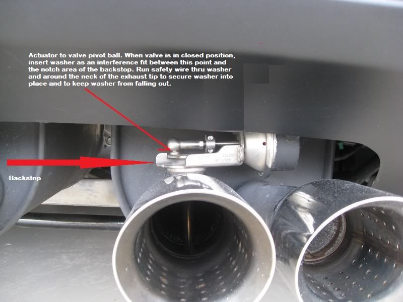

Ken...when I ran AMP's sound check late last year, I placed a 1" washer between the actuator arm (at the ball pivot that attaches to the cable)and the metal stop on the NPP housing (which keeps the valves from opening beyond center line), then ran safety wire thru and around the washer to keep it in place.
THe washer will be held in place initially by the force of the valve trying to close when the engine's off or limited vaccum, but you must safety wire it into place as the muffler gets hot and expands..which can cause the washer to dislodge.
Be careful you don't pinch a finger when wedging the washer in place when the valves are open...which is their default position when the engine's off.

Excellent, thats were I am going for the sound check on saturday. Thanks for the info. Just to clarify (I haven't got under the car yet cus my car is so damn low), are you saying a 1 inch O.D. or thickness or the washer? Do you happen to have a picture? Thanks again!
O.D.
I didn't take any pics, as I was in a hurry to get to the sound check before it got busy with all the crotch rockets I think it will make sense to you once you get a look at the actuators.
Just make sure when you get the waher wedged in there, safety wire it in there really good. As I was pulling onto the track last year, one of the washers worked it's way loose (guessing as the muffler heated up), which allowed one of the valves to open up.....car blew a 95.6 with one valve open
Tim (SLAMMER) on the other hand, went thru with flying colors....even with Fusions and LT's, as he has the retrofit NPP controller kit on his s/c vert which allows him to electronically keep the valves closed.

Originally Posted by ktoonsez
No biggy on the pics, I just looked in my shop at work and found some nice thick washers that might work nicely, but are 1-1/8 or a little less OD. Is that too big?
Give it a try....it's an interference fit when you wedge it in between the ball pivot and the stop on the bracket, so depending on how the actuator cable is adjusted (for the valve), you may need more or less.
You'll see what I'm talking about when you get to the mufflers on your car.
Here's a crude image with pointers showing the area I'm talking about.

Thanks for all the reply's guys. Looks like I am going to try the washer idea. I found a square piece of flat stock 1" wide so hopefully that will work as the washers here just a touch too wide at 1-1/8th.
