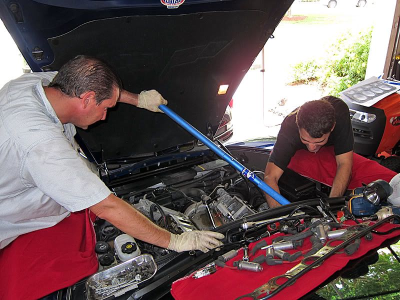

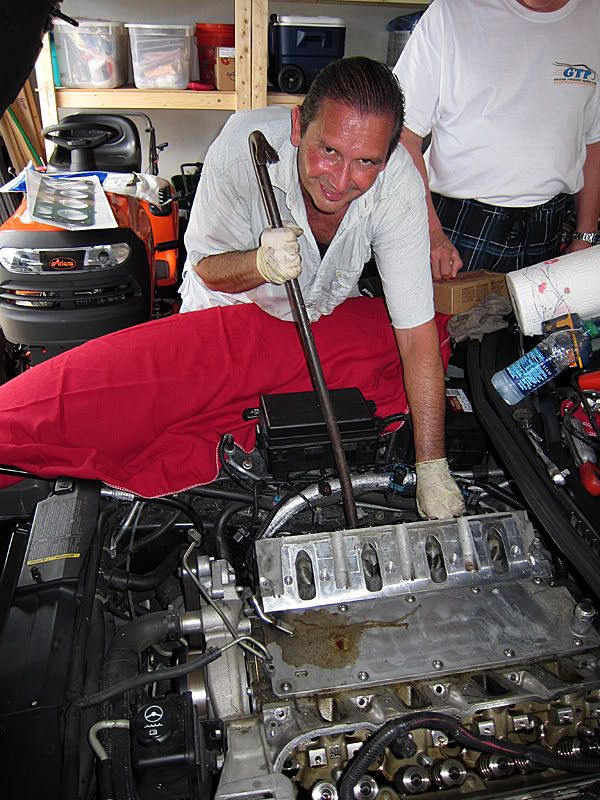

I'm with you...
I'm 46 and here I am wrestling heads off my car...thinking WTH am I thinking
Actually I enjoyed it. I miss spinning wrenches but when I do it, I'm glad I don't have to do it for a living anymore.
Originally Posted by Craigster05
Even the 100 degree heat of the garage, my buddy still smiles strong...even though he has to use a "Ford" tool as we used to call it
Cranking the bolts to the exact degree
Ed...if you're listening, we need a suction cup tray with a magnetic section to put on the window to hold stuff while we work....
He wouldn't let me help though...guess he is smarter than even I give him credit for LOL...could it have been those huge 2 for 1 Margaritas we had at the beach the night before??
It was great to see you guys...cant wait until I get back down...permanently!
