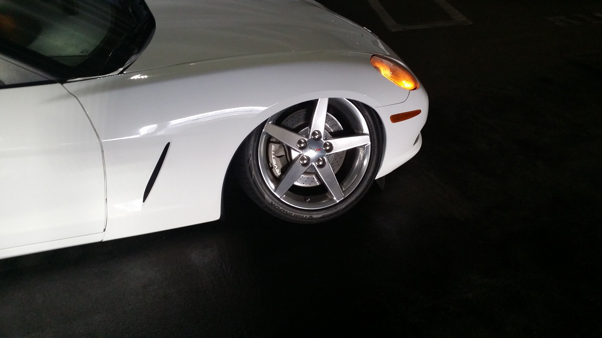

I know this thread is old, but just had this exact thing happen this evening. The wife was leaving work and turned out of her parking space and the right front suspension just collapsed. Car is totally immobile and to make matters worse, the car is on the top floor of a parking garage, it's blocking 3 parking spaces and half of an entrance ramp. Called 6 towing companies and no one has anything small enough to get in to retrieve it. Couldn't do anything but leave it and maybe stop by the dealership in the morning to get help there. We had the squeaking from that side mentioned by the OP prior to this and could never figure out where it was coming from. Could barely see under there, but it looks like the hub has broken off. Anyone else have something similar? Am I looking at a complete suspension replacement on that side? Upper and Lower A arm and shock support are still intact. Wheel, brake assy are basically ripped away.
This is a 2006 Z51 vert with 60000 miles.

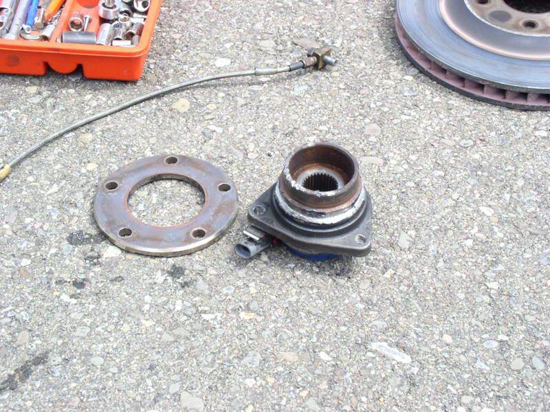

This isn't a case of the suspension collapsing. I have seen it several times although worse than what is pictured. I believe your wheel bearing hub has separated from the main part of the bearing and the bearing needs replacing. This could have also damaged the knuckle where the brake caliper is fastened, brake line and body work in the wheel well.
This has been known to happen to stock wheel bearings on cars that have seen a lot of track use. It is one of the reasons people buy the SKF Hubs/Bearings as they have a thicker metal where the two parts are welded together.
I am attaching a picture where this happened to a C5 while on track at speed. One reason this may have happened is because the owner used a rear wheel bearing in the front of the car. The two parts are interchangeable from a fit standpoint but not from a capability standpoint. The rear bearing uses the axle to provide stiffness while the front is made different to sustain the extra force due to cornering. When the hub separated (at just a little over 120 mph) from the bearing the wheel, brake assembly, the brake line and part of the knuckle decided to go on a trip of their own and jumped over the guardrail leaving him spinning along the track. Sort of comes under the Crap Happens collection.
You probably don't want a flat bed to get the car as it could cause a lot more damage to the car sliding it up the ramp. You need a wrecker that can lift the front off the ground while containing the wheel so it doesn't do any more damage.
