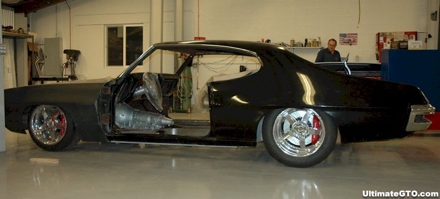

well I have a c6 cradle on a 1970 gto, lowering 3-4 inches isn't a big deal.
Its just my body is probably 9 inches off the ground, that means my frame is at 10.5. I am going to drop the cradle by about 2 inches.
which would put the body at 7 inches.
I currently have a "c6" spring with the lowering bolts and I will be at 8.5 on the frame... I would like to be at 6.5 on the frame.
The Z06 uses a different spring, I was wondering if the z06 spring has the inherent "2" inch drop built into it. Then you can lower or raise the z06 with the factory bolts.
I want to be about this low...

"same" geometry... same weight if not lighter. I also have a LS3 and TR6060 in the car, like the car in the pic, its a fiberglass front end.
Aluminum rebars front and rear, I maybe putting rebar shocks on the car if I need to up the weight. I am getting VERY light. Stock is 3700 lbs... the rear bumper and front bumper takes alot off there, fiberglass trunklid... front clip loses nearly a ton, doors are like tanks though. I am estimating 3500 lbs.
obviously there are some differences(105 wheelbase vs 112).
This car will be a "two seater" since the engine is pushed back about 6 inches into the cabin.
I have built everything to c6 spec(purchased the upper control arm mounts) on my wheelbase and I am getting my frame down.
I am going for coilovers but I am just trying spell out my options.
Corvette is only 1 inch wider wheel track up front.
I am kind of just doing the mock up right now, cut the firewall back and my frame is a little higher than I would like with the stock C6 spring and lowering bolts.
I am dropping another 2 inches on the cradle mounting. I guess I will just get the coilovers now and make my life easy. I just wanted to know if you could simply lower a c6 with z06 spring(leaving the bolts in approx same area).
