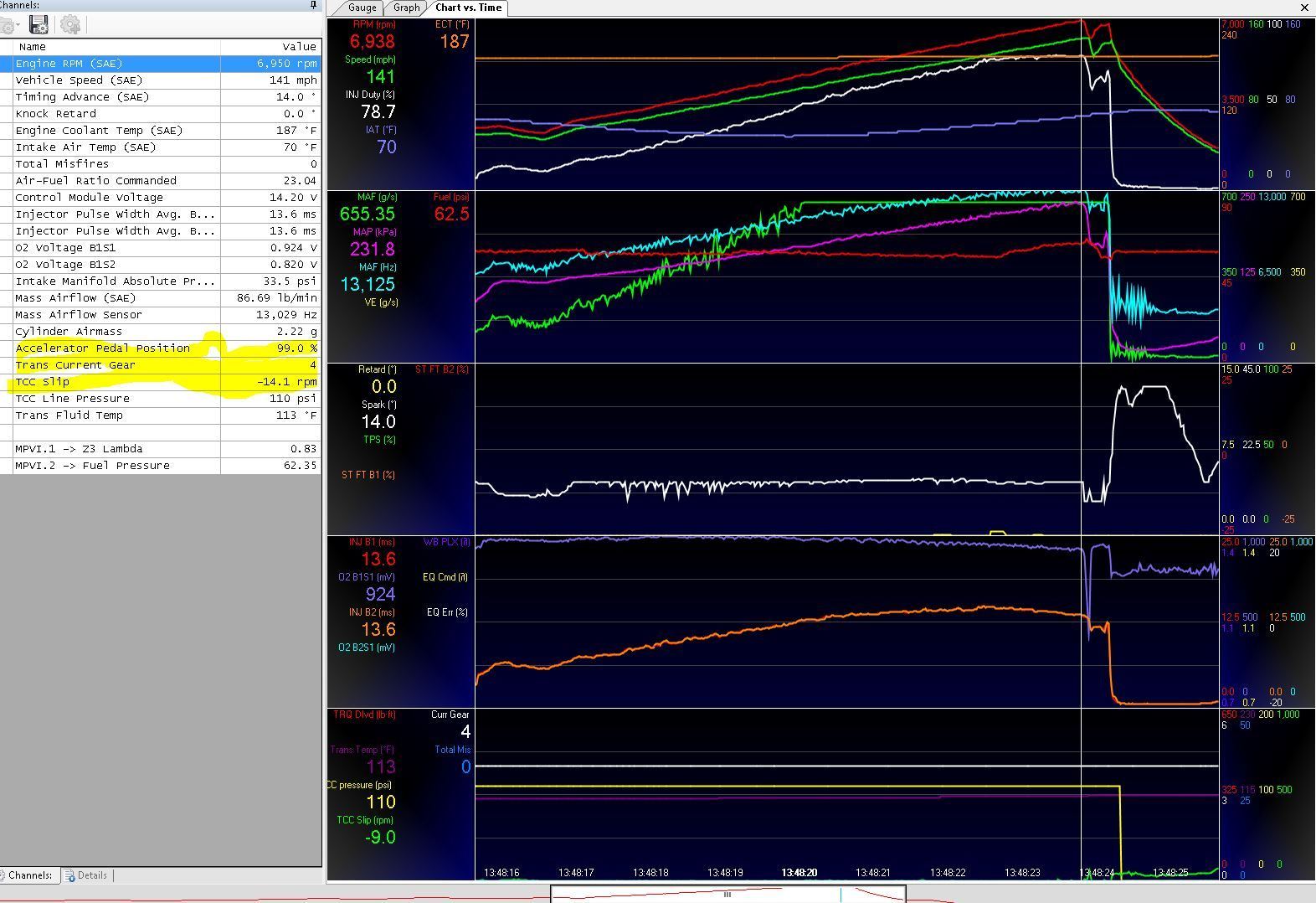

Are you saying your converter will not lock while driving it on the street ??
Street tuning a high stall converter takes some special tuning
1 You must set all your desired shift times to "0" to put the trans in adaptive shift mode
2 You must delete all your misfire codes ( as a stall creates false misfires)
3 You must set your TCC pulse width modulation tables to read 98% low and 99% high
Now if you tuner is trying to lock the converter on the dyno--This cannot happen as GM UNLOCKS all their converters when your car goes to WOT---

Not to mention most of this is all wrong.

Yep, you are correct - for a lot of setups you can literally get away with doing absolutely nothing to the tune and end up being perfectly fine.
If however you're making decent power and are a hardcore racer then you'll need to lower your commanded shift points to help stay off the rev-limiter. Other than that though nothing is required.

All this data is taken directly off an EFILIVE trans tune file for either a 4 speed auto trans or a 6 speed auto trans
I would suspect you have never looked at a Auto trans tune file with real tuning software---otherwise you would know all I said is correct---You cannot lock any GM auto trans in the tune to make it stay locked at WOT---- In order to lock the TCC at WOT you must input a value above 100% TPS to keep the TCC locked at WOT However the table ends at 100% TPS--so it cannot LOCK
Maybe if using the DVT system in EFILIVE you can temporarily lock the TCC at WOT on the dyno But I have never been able to make this feature work
If you have some magic way to lock the TCC at WOT Please share it with us---Otherwise youu are simply mis informed--

This nonsense really doesn't deserve an answer but I can assure you I've seen a file or 2 since I tune my own car.
Magically, my converter stays locked at full throttle any time it's commanded to.
I will leave it at that.

Ok guys I was mistaken on a C5 and a C6 as far as TCC lockup at WOT or 100% TPS--I was thinking of other manufacturers TCM tune files at the time and got confused------YES you can re-tune an A4 or an A6 to remain LOCKED in all gears at WOT ( but just not 1st- on an A4 ----- Sorry for the mis information --
We all make mistakes but only few people admit them---
PS Just so you know I've tuned over 2000 GM gas cars and trks from stock to boosted as well as 200 Ford Mustangs and 300 of the new Dodges --- 15 years as a Pro tuner----- also over 500 D Max Diesels- 200 Powerstroke diesels and 300 Cummins diesels
I have so much tuning information rolling around in my head that I got mixed up on this issue Again sorry--
