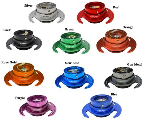

I had a hard time finding this information through searching so this will serve as a reference for those who wish to install a racing wheel and quick release into their corvette C6
Parts needed:
Hub adapter:
NRG is the only company making one for our cars, its a great looking peice, solid but not heavy.
Quick release: Quick release:
Again, NRG is fantastic. They are big in the import world but their youtube videos caught my eye. The unit is solid, light and most importantly releases quickly and retains a horn function if you desire.
Steering wheel
I wanted slightly smaller than stock with a D-bottom as well as an integrated horn so I went with the OMP Super quad
Now use this link and remove your old wheel. I was lucky and did not need a puller. I harnessed myself in and pulled forcibly.
This is how it went in:
The button they removed is an additional lock on the release mechanism. I removed it as well for faster exiting, this step is not nessiary for installation.
After about 45 minutes this is what you get:
By using the NRG short hub and quick release the stock distance of the wheel is retained.
I hope this was helpful, have a great day.

So this is why DS vettes can charge what they do for their wheels, they retain the OEM SRS system. Mine has been deactivated since I installed my 5pt harness and corbeau seat install. The light is on but does not bother me. Im sure it can be fooled with resistors but I won't do that until I have the passenge bag out to prevent accidental activation.

So when going with the NRG hub/quick release, you dont have to remove the clock spring??
Old Aug 4, 2019 | 09:30 PM
Silver c6 z-51's Avatar
Silver c6 z-51
Joined: Apr 2009
Posts: 203
Likes: 27
From: Shelby Twp. Michigan
Correct, not required
