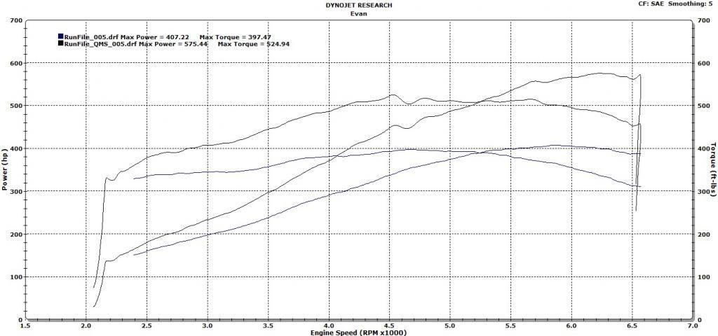

Do the blower. Don't need anything other than the kit (A&A is what I used, but there's also ECS and Procharger). I went from 407RWHP to 575RWHP with no other mods, and the car is awesome! Drives like stock when I'm not on it, and is a beast when I floor it. As to the clutch, I'd just run it with the existing one until it gives out (if it does give out). Chris from Callaway has a 2010 GS with their blower package that has over 200K miles and is still on the original clutch. And if you really want the lope, put a blower cam in and make even more power!
BTW, here's the graph of pre/post blower on mine (and this was with it pulling some timing due to being hot and on it's 5th dyno pull after tuning):
