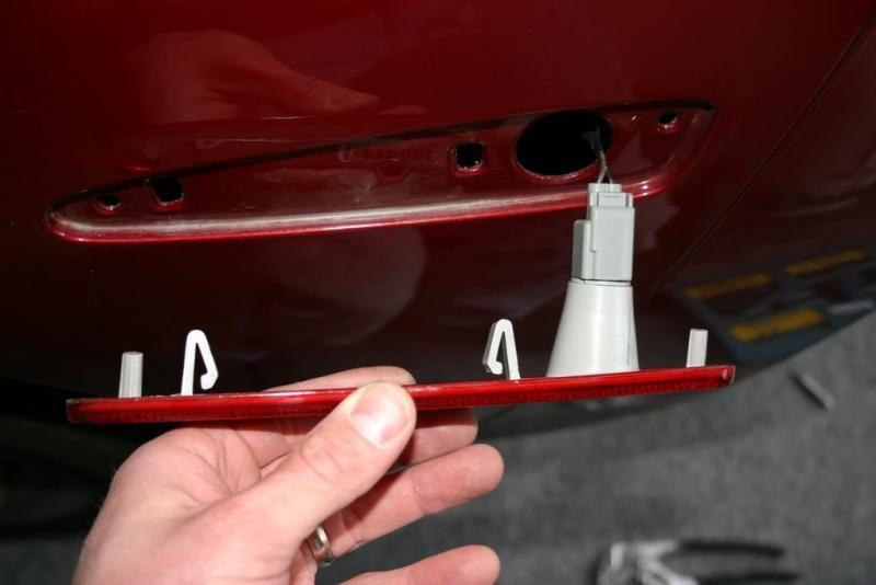

I just bought a 2011 GS. the front side marker lights do not look like they are flush. the front of the light seems to stick out further than the bank end of the light. How do you get to them to even them out?

It is the fit on the front ones, they are kind of in more at the back then at the front. Maybe it was made on a Mon. I was thinking if I could get up into the fender, I might be able to un screw them and just move them a little bit to even them up with the body.

The thing is they don't unscrew. They just snap in with little built in clips on the back. If you take the push pins out of the edge of the fenderwell liner you can get your hand back there and pop them out. Maybe push in on the front part and see if they are completely snapped in place.
