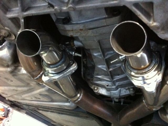

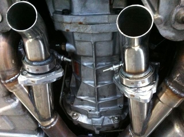

Finally got around installing these. These came from speed daddy and came complete with all parts needed including ss and alum tubing, gaskets, switches, wiring etc.... i bought two. My experience with them has been very favorable--so far.. I Had trouble with one of the wiring harness, called them and they shipped a replacement w/n a week.
I did all the wiring then took it to a local muffler shop to install the cut outs.. I installed the toggle switch in the ashtray area... modified it some - cut some plastic, but kept the function of the door - you can't see it when it is closed. Ran the wires thru tunnel below the shifter and to the back...very simple to do...just takes time to take off all the center console off..
Once installed by the muffler shop the sound was insane,,..what i noticed too was that even with them closed the exhaust is a bit louder,,,but when they are open,,,, you know they are open...at idle is bearable...but at WOT...its incredibly loud...
Took it to the local cars and coffee and it was quite a crowd pleaser...its actually pretty cool to just flip a switch and have a race car feel...my car is cammed so it sounds really neat...
Total time was about 2 hrs me doing the wiring and about 2 1/2 hrs at the muffler shop. Total investment +/- $600...
il post a video tnite

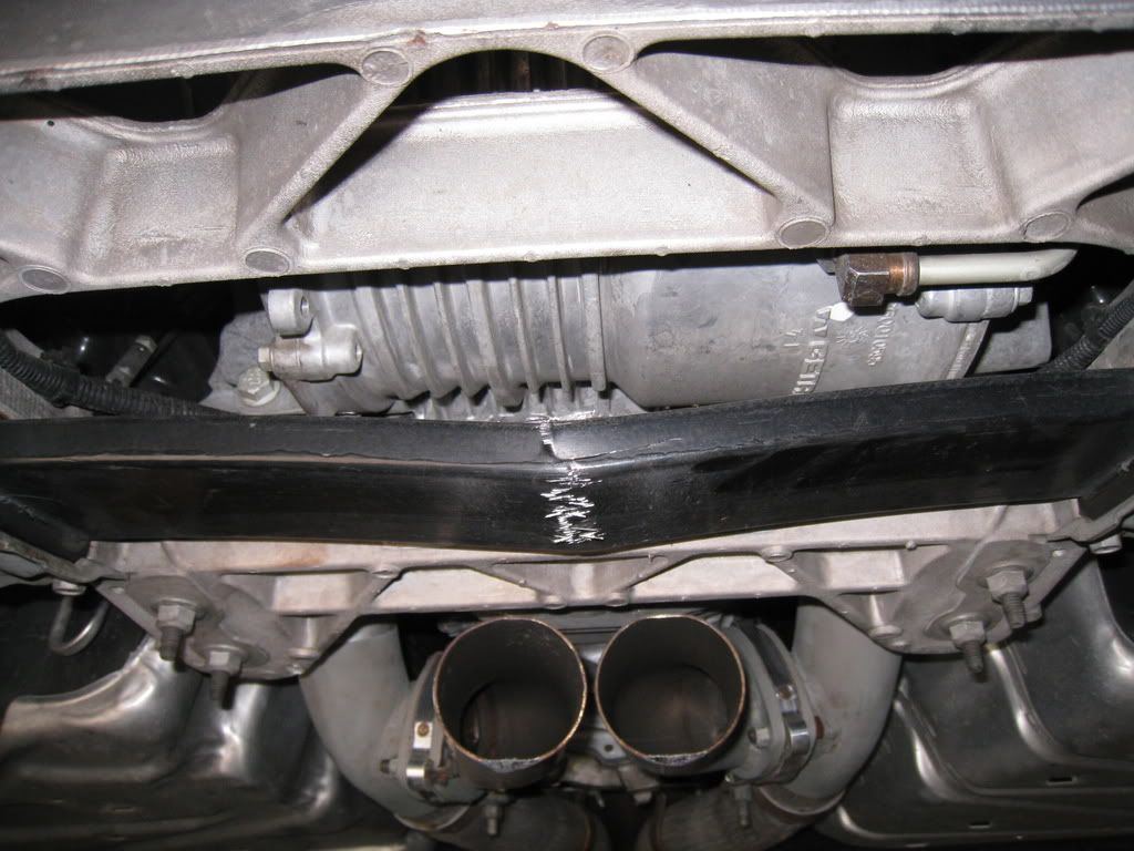

My advise for what it is worth is to install them after your rear diff. You do not want to get your diff hot or your rear spring and they will get hot in traffic.

hmmm, intersting setup crowhtr....i researched the install and many ppl put them where i did..but i see your point....i did leave the tailpipes uncut after the elec cutouts and they point downward away from the leaf spring...hopefully nothing will happen....i took my buddy for a ride last nite with wdws down and when opened you cant hear yourself speak inside the car....im talking loud loud...but sounds sooooo cool.....

Looks good. I wanted 3" cutouts so I opted for the QTP low profile ones and needed to put them ahead of where my exhaust necks down to 2.5 at the over-the-axle portion so this was the only way I could figure to install them.

I hope you know I was not talking bad on your set up! It looks very nice I just suggest you be aware of the heat transfer. I don't remember the post but a member showed pictures of his rear spring failing because of the heat from his cut outs.
I recall that too. But I think they were pointed ~at the spring. With the turn downs on OP's setup I think it'll be fine.

no offense taking buddy..thx.... and yes i remember that too..they were pointing straight back...to the spring..
