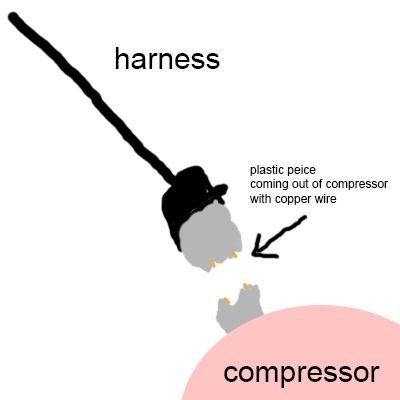

Maybe I am missing something here - but Here is a quick doodle of my problem. Are you guys saying just glue the piece back on and hope that the copper wires still make contact?

Originally Posted by robertwhamm
maybe i am missing something here - but here is a quick doodle of my problem. Are you guys saying just glue the piece back on and hope that the copper wires still make contact?
no!

How much wire is sticking out? Can you clip back some plastic to get more wire to solder to or crimp a electrical connector to?

Ok I must have misunderstood. If the wires from the coil have been severed between the coil and connector then you'll have to replace the coil.
