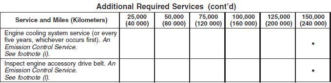

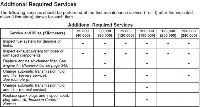

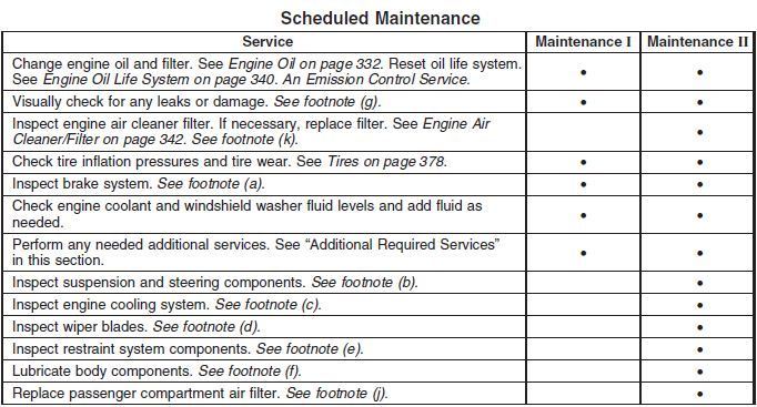

Beano 07,
You may find the following information helpful. Maintenance intervals, checks, inspections, replacement parts, and recommended fluids and lubricants as prescribed below are necessary to keep your vehicle in good working condition. Any damage caused by failure to follow scheduled maintenance may not be covered by warranty.
The following schedule is for vehicles that:
• carry passengers and cargo within recommended limits. You will find these limits on the Tire and Loading Information label.
• are driven on reasonable road surfaces within legal driving limits.
• use the recommended fuel.
Maintenance I — Use Maintenance I if the message comes on within 10 months since the vehicle was purchased or Maintenance II was performed.
Maintenance II — Use Maintenance II if the previous service performed was Maintenance I. Always use Maintenance II whenever the message comes on 10 months or more since the last service or if the message has not come on at all for one year.
Let me know if you have further questions.
