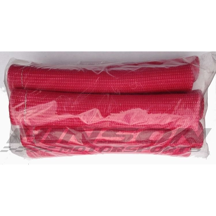

Originally Posted by omegaboss
I just purchased a set of ceramic coated SLP headers for my 2011 GS and will be installing them shortly. I have 3 questions to ask
Question 1 is about the need to protect your plug wires and or starter with special sleeves or covers. I would appreciate any advice or thoughts on what you have done for your installation.
We have a new line of heat control product including plug wire boots in various colors.
Question 2 Also, I have read a thread of two about the O2 sensor wires. Are there any special methods for covering them or tucking them away using ......?????????
On these we have used a heat reflective sleeves to protect against the heat. We have also used this stuff on twin turbo cars to protect various wiring harnesses.
Question 3 I live in the Pittsburgh PA area. Are there any tuners that you would recommend after I install them?
Sorry can't help you in this department.
Thanks very much for your insights.
Here is a link to our full line of heat control items such as, boots, sleeves, x-pipe blankets, header wrap, and ceramic coating.
Heat Control
