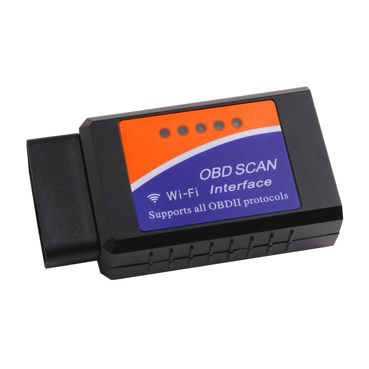

http://ecx.images-amazon.com/images/...L._SL1500_.jpg

Your running the device cordless to your Iphone (through wifi, so the device needs to be Wifi, not blue tooth), and you want it low profile so you are not hitting it with your legs as you are driving (look in the car to see where the ODBDII port is, and not that it right above your legs).
This is the unit I run for my Iphone running dash commander.
Note, when your not using it, unplug if from port/reach up and hit the off button since will stay live if you don't turn it off or unplug it and drain the battery.
http://www.obd-tool.net/goods-123.html
