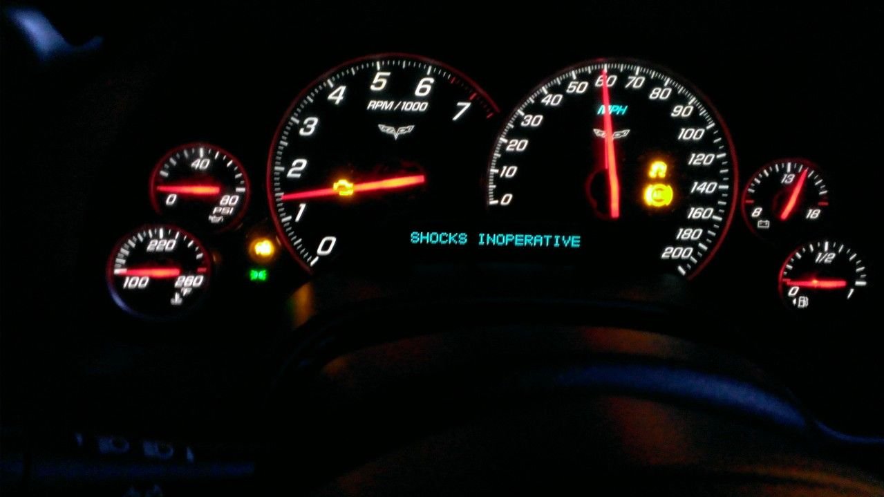

Last year, my dash started throwing seemingly random errors after driving around for a bit. Stuff like:

The dash’s gas / temp / pressure gauges would zero out randomly, the CEL would come on, Traction control light, ABS light would illuminate, etc.

Pics of the dash when it happens while driving:
http://imgur.com/GA7G9p7,TtVw03k,QAxSrXU
