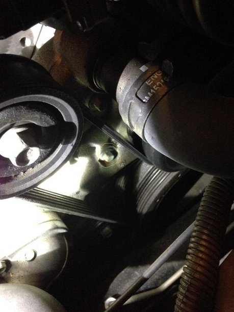

08 Vert, 14k miles. Just noticed about 1/8 cup of coolant under the car. It's probably dead center left to right between the wheels under the engine. I took a pic and tried to draw a circle around the bolt where I can see some coolant. It almost looks like it may be coming from above the bolt, but I can't be sure. The pulley was pretty wet below it though. Any ideas on where to start looking? I'm no mechanic and will most likely be taking it in, but I wanted to get an idea of what I could be expecting. Thanks.

more than likely it's coming from the water pump

Unless coolant is running down the underside of the upper radiator hose, your water pump is leaking. A new OE pump is $275, plus coolant, plus labor to install. It's a pretty quick job.

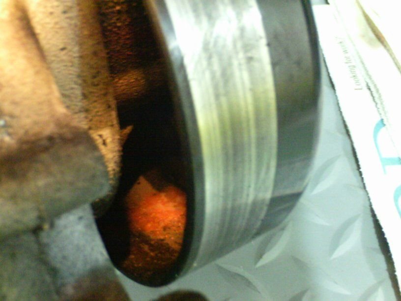

I was determined to find that leak...I knew there was one somewhere.
I put the pressure tester on at 18 psi, left it for 24 hours, and in that time the pressure dropped only 7 psi.
I looked to find the leak, or drip or anything, and I finally saw a small stream (drip) of antifreeze (glycol) from behind the water pump pulley, and even saw small amount of a liquid or wet shine on the pulley belts, just below the pump, where the leak had dripped on the belt.
I then knew that the pump seal was leaking, although very little, and probably only when the shaft seal was stopped in the right position. I was thrilled to finally find the issue!!!!!
Here is the pic of the old pump.
I have put 40 K miles on the replacement water pump, and not a sign of any more leaks anywhere
I'm betting that 99% it's your water pump seal leaking.

Reviving the thread to add relevant info since this is one of the first threads which google shows when searching, and OP could have potentially been dealing with the same issue.
I had a very slow coolant leak from the exact same location for which would every few month or so cause the DIC to give me a check coolant level warning, as well as coolant covering the lower front of the engine and front subframe, but not the radiator area. Coolant temps were not really affected significantly yet by that point.
The leak was directly over those pulleys and would also cause a belt squeal the first time I accelerated while turning after a cold start.
I found the cause of mine as a weak hose clamp/improperly placed hose over the water pump output nipple. The hose was sitting in the same location on the nipple as the hose in OP's picture. Barely touching the clamp while hot resulted in a fine mist of coolant spraying out of the fitting.
After moving the hose over so it was flush with the water pump, the fine dripple of coolant stopped, as well as the 5 seconds of belt squeal that would occur after the first time I put a load on the belt with the PS pump at ~2-3k rpm. Touching the clamp while coolant is pressurized no longer has coolant spraying out as the barb on the hose is securing it properly.
Apparantly that first section of the water pump fitting is not an indicator of where to place the hose, but just a barb which the hose goes over in order to secure the hose on the fitting.
