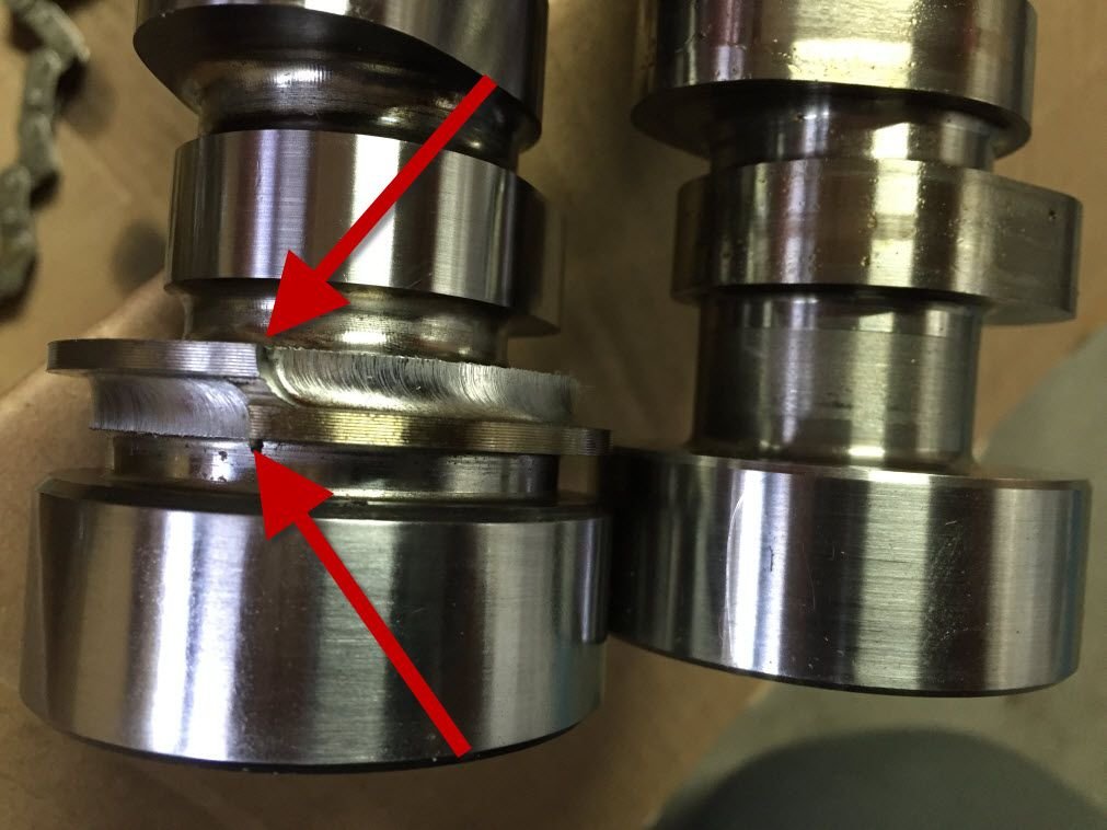

Was about to install a new cam that I had ground, and noticed this at the end of the cam near the last journal that is at the back of the motor. It doesn't look like it was finished machining and left some stock material on it. My old cam is beside the new one for reference.

My brand new Black Mamba has it as well.

Is this an issue? Did you install yours? I called the place that did mine and, of course, they are closed for the weekend. The edge is pretty sharp so I'm waiting to install for the time being.

I googled it and it's a trigger for LS1 cam sensor.
That explains why your stock one doesn't have that trigger.

Thanks for the feedback!! Now that I know what it is, I also Googled this and found the same thing. So, I guess I'm good to install it?

Yes. Go ahead and put it in.
