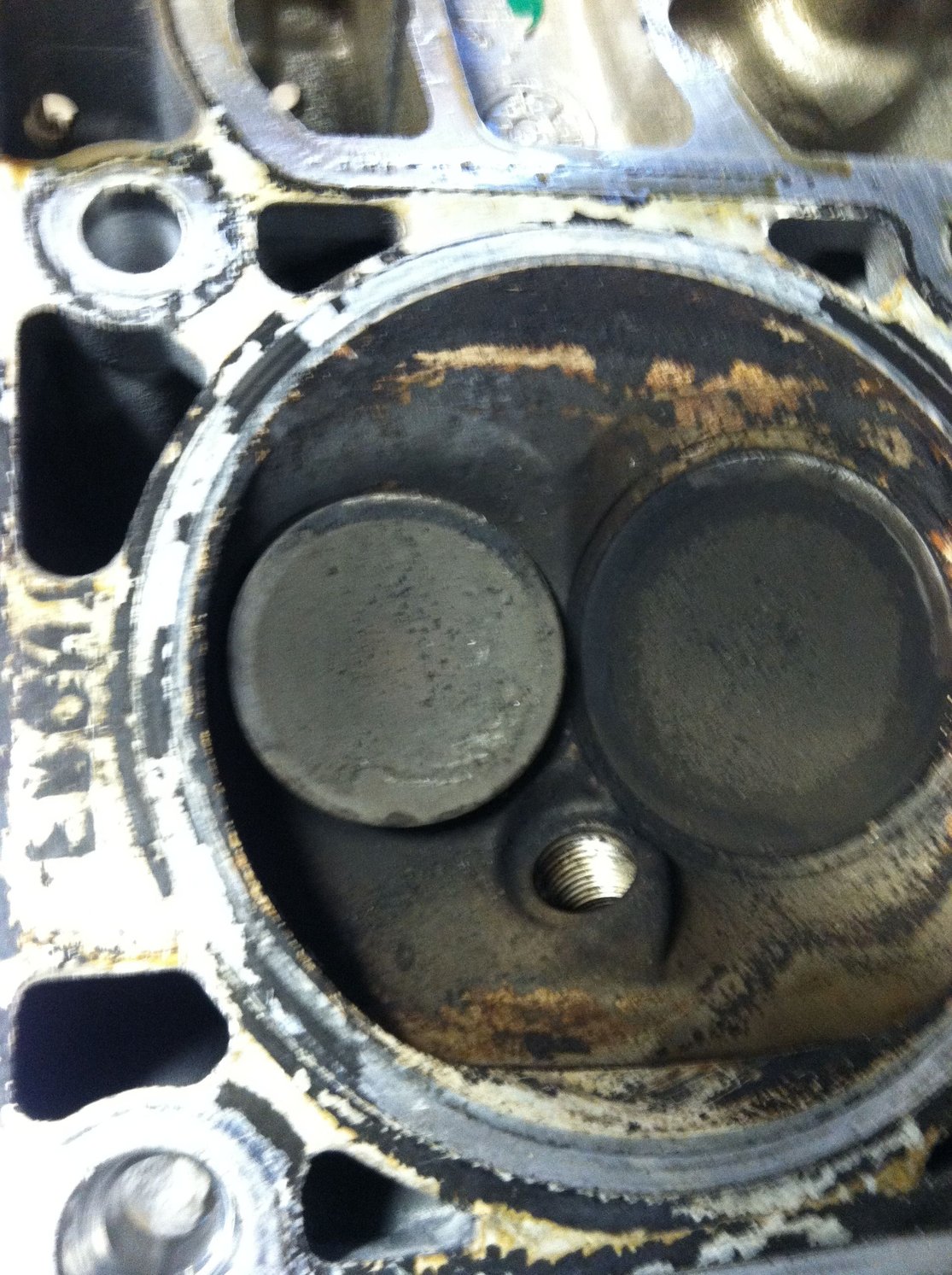

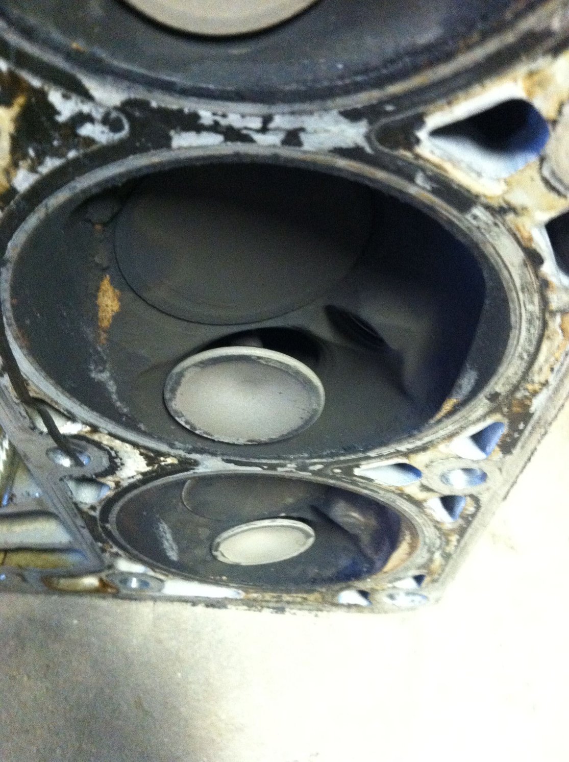

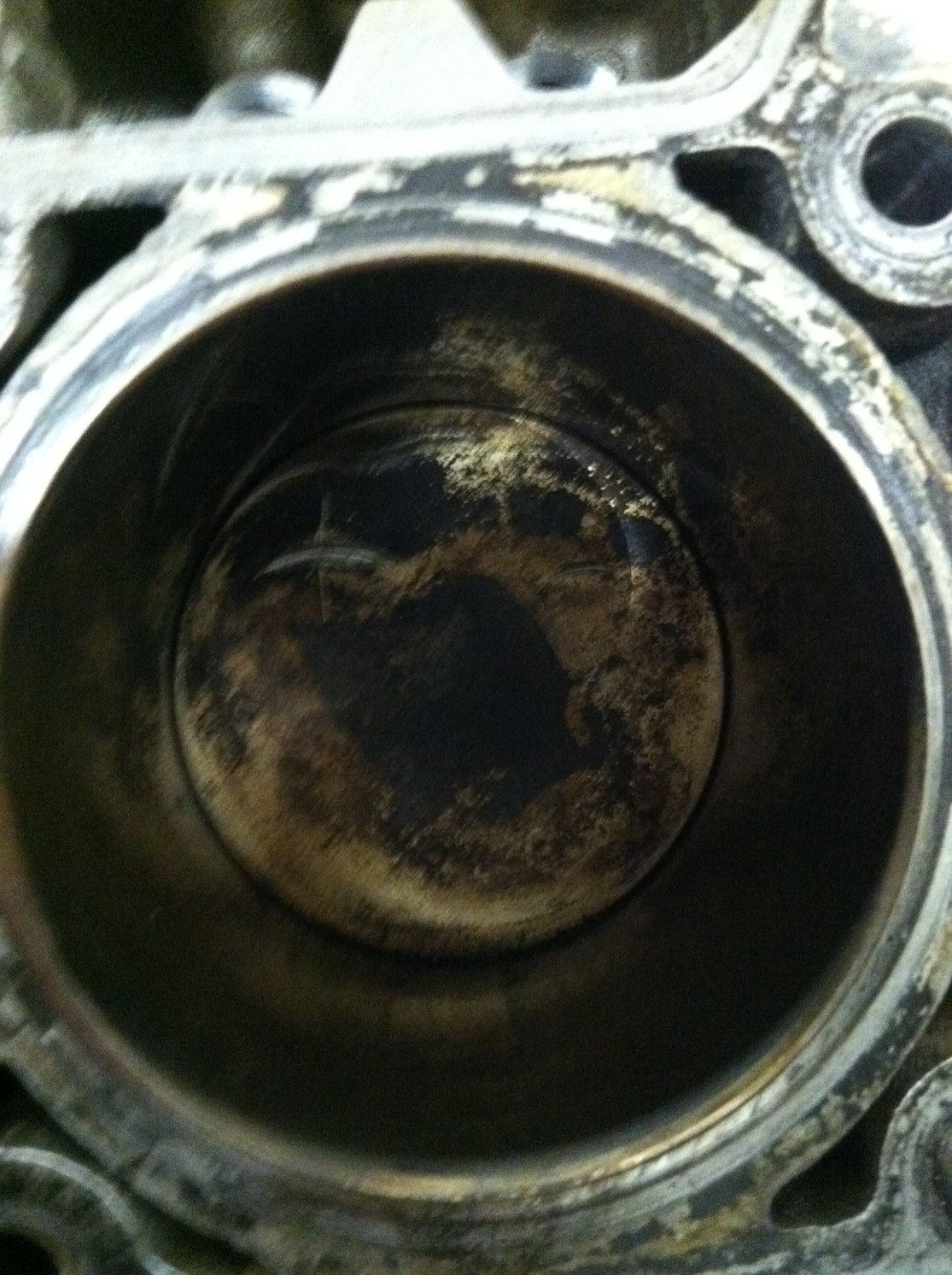

So I know its been a while since an update so here is the deal:
The block and pistons were still usable. The areas where the valves kissed the pistons did not do any great damage. From the information I received and the mechanics recommendation we decided to just clean up the areas on the pistons and use the stock bottom end. I went with aftermarket heads, a larger cam, and a few other parts were put on while the engine was out of the car. I will create a build thread when I get a chance, more than likely after I get the car to the tuner. I have to admit that I'm stoked to have the car back. Love the new idle sound. Here are some pics of the carnage from the timing chain failure. I didn't take pictures of the chain in half, or the dampener that had been sheered in half by the chain.
Thanks for all of the help and advice yall offered. Ill post a link to the build thread when I create it.
