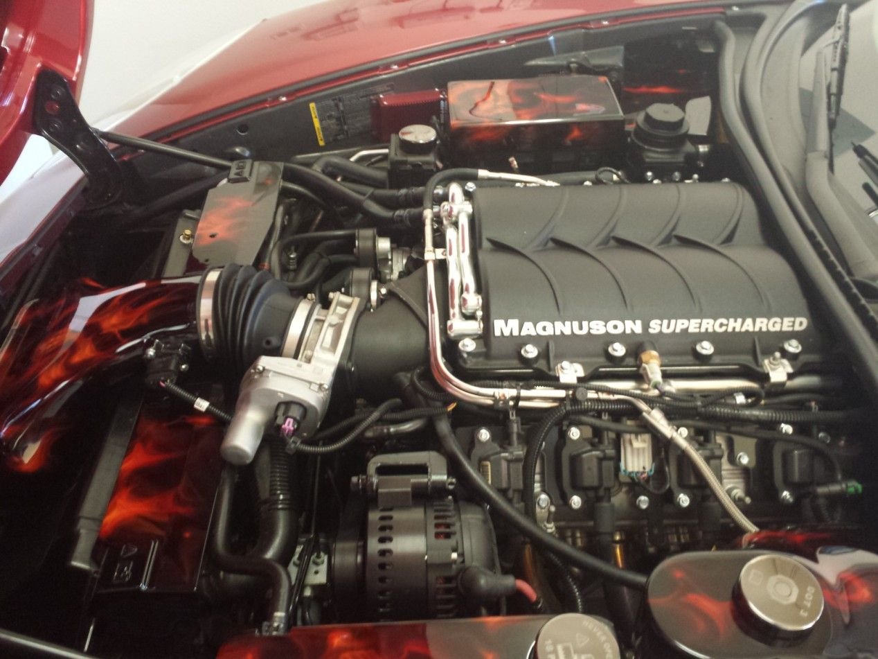

I'm running pfadt tri-Y long tubes with hi flow cats and have a supercharger and have my car lowered and have had no issues whatsoever over the past 2 years....i can get under the car and get a better pic if needed....pm me if needed...

I like how you did your alternator in black besides all the other awesome stuff.

thanks, billet tech 170amp alternator - really does a good job...
