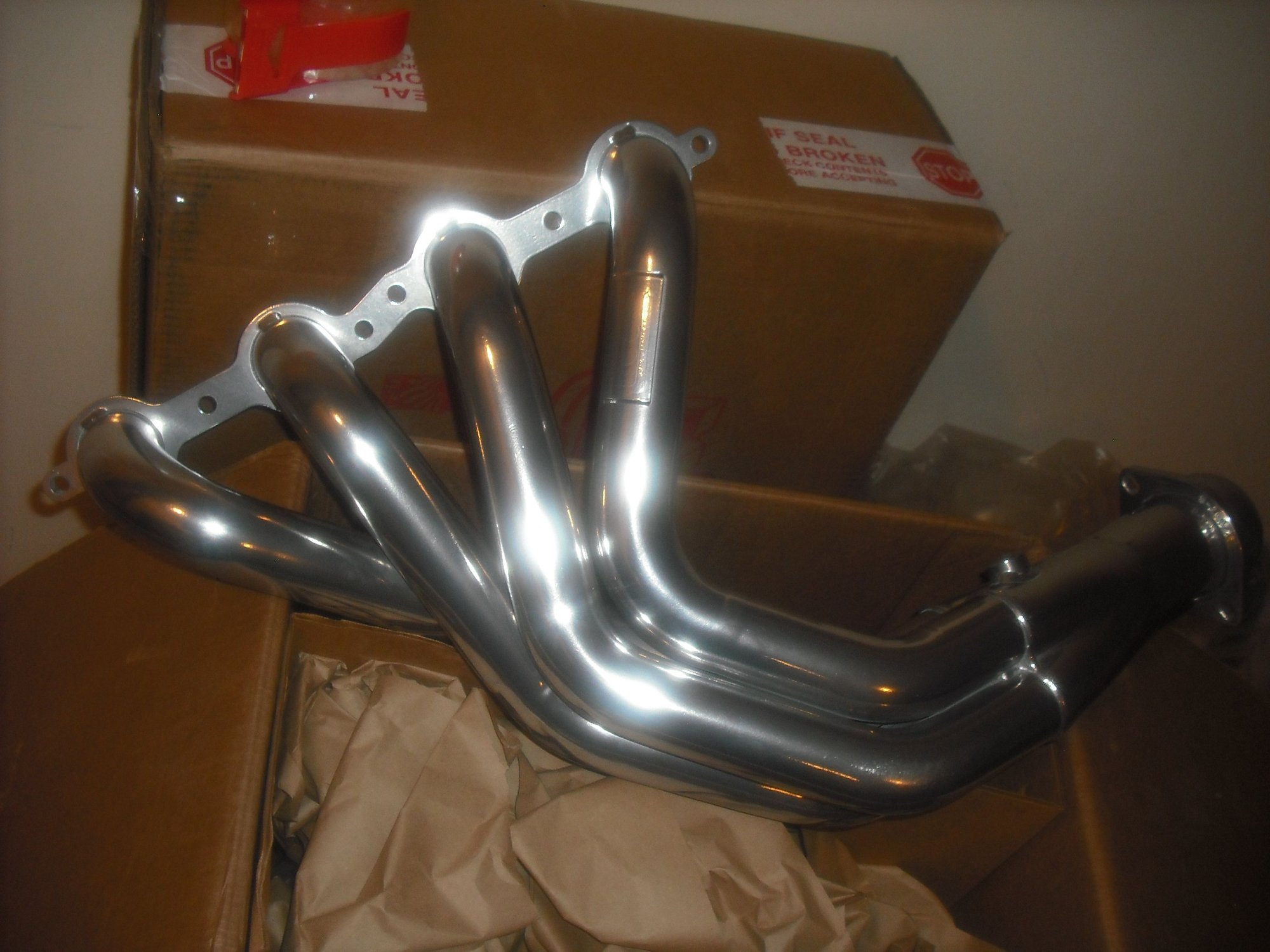

I went w/Kooks 1 7/8" Longtubes on my '08. ( http://marylandspeed.com/kooks-1-78-...-ex-p-745.html ) I ordered from Marylandspeed w/the option to get them ceramic coated before they shipped them to me. Shipping was free & the coating was free when I entered the coupon code ('freecoatkooks') The coating I picked was called 'Airborn 1700 deg Silver Jet Coat'

On my '08, before the mods & tune, the car was entirely stock & made 375 rwhp/376 lbft. The mods added were; Halltech MF103 CAI, Kooks 1 7/8" Headers, Kooks Catted X-pipe & Corsa Xtreme exhaust. That brought it up to the 412 rwhp/402 lbft. I went w/the 1 7/8" because "the future's uncertain"...I liked the idea of the bigger tubes, you know, (just in case). It seemed like I didn't loose out on TQ anywhere by getting 1 7/8", so I don't think you're leaving much, (if any) torque on the table by getting 1 7/8" instead of 1 3/4" headers. The LS3 can breathe.
