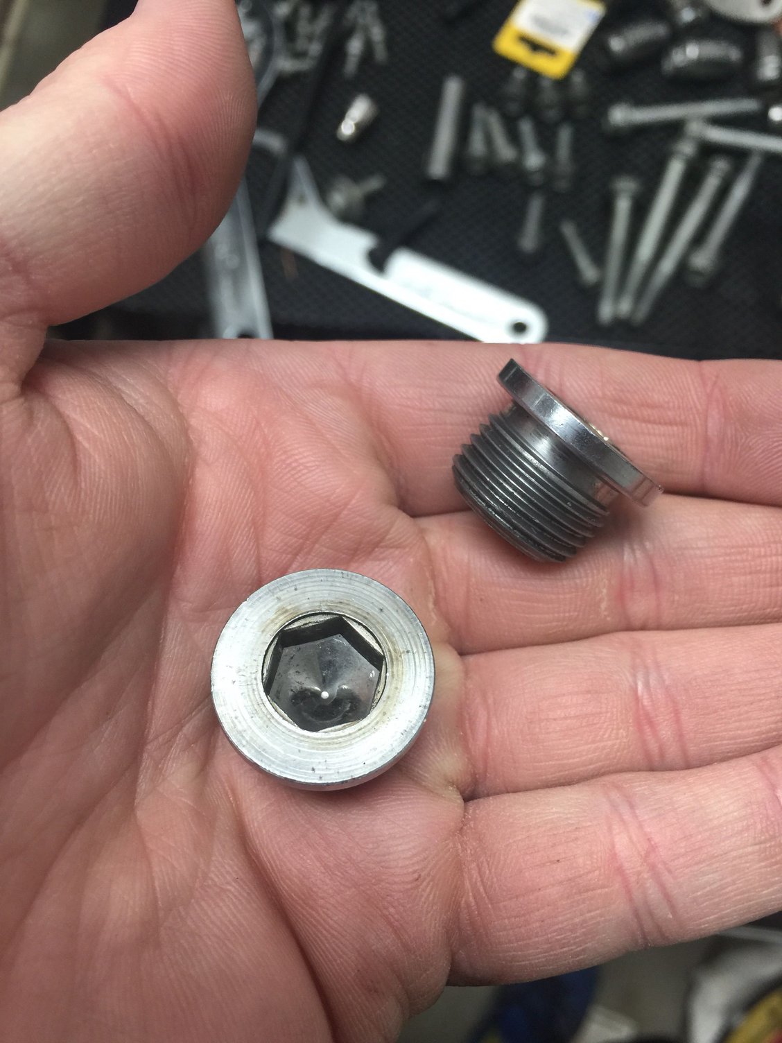

Stripped off my out of spec LS7 heads and sent them to WCCH. Got them back and reinstalled... HOWEVER now I have these two plugs and NO clue where they go.... Educate me please.

Coolant temp sensor goes in driver side head. Plug goes in passenger side head.

Make sure you put a little lock tight they dont require much torque since the heads heat up...

Looks like o2 bungs hole plugs to me.
