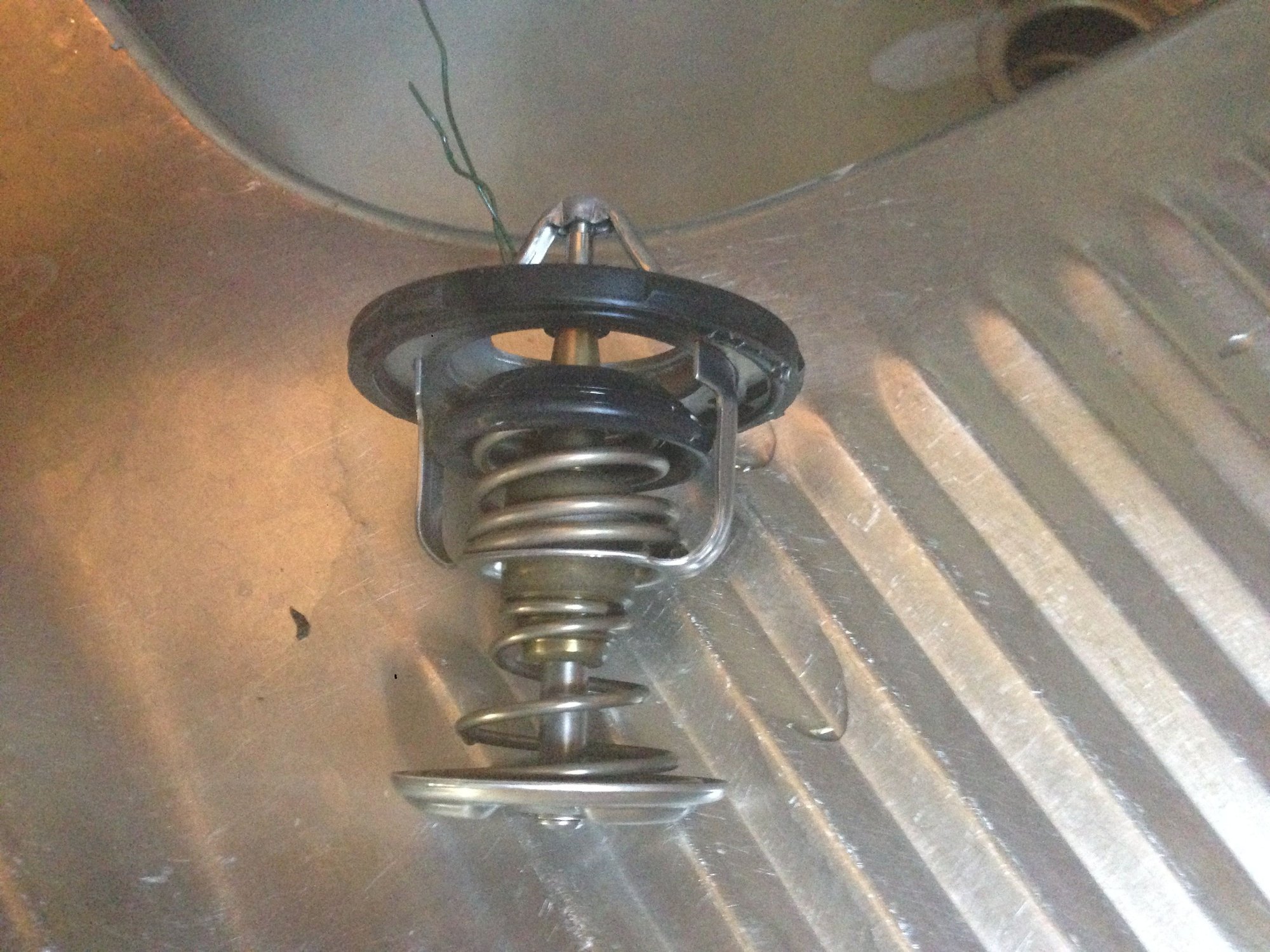

Basic (read cheap) multimeter will work for the ohm resistance check to see what the resistance is across the ECT sensor to tell you if its it is out of range or not. The replacement may be out of range for resistance values, but if not once you test is to make sure, better guess would be in the wiring or ECM.
Note, check the old one's against the new ones. If you are getting the same ohm resitance from the orignal one, the after market replacement, and even the new AC delco unit, the sensor is not your problem.
Replacing the ECT will allow for some fluid lose to create a air pocket in the head (which the ECT will warm up fast since it only seeing the metal contact of the head, and no water flowing across it), but so long as the T stat has an air weep hole, the air trapped in the heat should be pushed out of the system at start up and back in the tank before the T stat fully opens (no weep hole, and the air is trapped until the T stat opens, and then the water now moving through the system can flush the Air pocket out, and pull fluid back in from the tank).
The brass thing in the T stat collar flange is the air weep hole (gets mounted top dead center when the T stat is installed in the water pump channel), and for some reason yours T stat did not come with the air weep hole, pull the T stat, then break out a 1/8" drill bit and drill a hole through the collar in the same location, which is TDC of the collar when the stat is mounted in the water pump.
Without the weep hole, the air is trapped until the T stat opens, and then the flowing water will push the air out of the system.
So on that note, the problem could be just a Air bubble in the head if you have a none weep hole T stat, and until the T stat opens, it going to flake out the ECT.

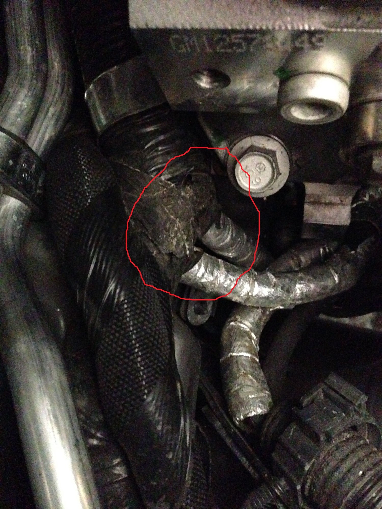

As for the wiring, try this unit you get a mulit meter.
Unplug the ECT connector, and put the car in to run mode without the car started (hold the run button for around 10 seconds with your foot off the clutch/brake).
You should get a P0116 to P0118 codes since the sensor it not plugged in/ the ECM can not see it, and the temp gauge should not be pinned to the right.
P0116 Engine Coolant Temperature (ECT) Sensor Performance ECM
P0117 Engine Coolant Temperature (ECT) Sensor Circuit Low Voltage ECM
P0118 Engine Coolant Temperature (ECT) Sensor Circuit High Voltage ECM
If you are not getting a code, then the wiring has a short in it, and this is what is giving the ECM a Resistance value instead with the ECT unplugged (this slight short, plus the Resistance across the ECT when plugged in itself, is cause the ECM to see the lower resistance; make the ECM think that the coollant is hot when it not.
If such is the case, then start going through the wiring harness back to the ECM to look for the wires melted together somewhere to case a slight short, and if push comes to shove, pull the connectors off the ECM to clean them them with Electrical contact cleaner.
Note, if you had a dead short between the two wires, the car should be throwing a code. Since it a lower resitance instead, makes me think that the problem is a corrosion problem instead.
Also to point out, with the ECM unplugged, go back and check the ECT connector wires again with the multimeter. There should be no resistance across these two wires of any kind (read first check with the wired still connected to the ECM and ECT unplugged, may show a slight resistance from the ECM circuitry itself).
The ECM is the silver finned box, and you get to it via pulling the back passengers wheel cover with the tire removed.
Now the fun one, and the problem could be corrosion in the ECM instead. It could be across two of the pin in the socket that is resolve via just cleaning the sockets with you clean the connectors with spray contact cleaner with the ECM still screws in place, or it could be in the ECM board instead.
Note, when you look at the ECM sockets with the connectors disconnected 9and just the area of the ECM), will be able to tell real quick if it was water logged/looks like it was stored in a fish tank (pins will be corroded). Why GM desired to put the ECM outside the car, low in the fender void is beyond all of it. Hence it the reason that every one jokes about driving in the rain, having to go through any standing water puddle; but is the the true fear instead of drowning the ECM and it's connectors. If you look at the above photo, you can tell the the fender void area in this car has seen a lot of water.
If everything checks out good, such as the wiring harness fine, no air trapped in the coolant system, The ECT sensor good, and the connectors/socket pins cleaned on the ECM, then I can take you down the rabbit hole of pulling the ECM apart so you can Spray contact clean it's internal parts if the problem is there.
And again, the Temp dial gauge, and the DIC are both agreeing on each other (ECM thinking that the water is hot), so the problem is from the ECM back to the ECT.

So, just came back from the Vette, new battery is in place and new OEM coolant temp sensor in place too.
Start it, (started better than with the old battery) and let it warm up. Temp climb to 56°C and the exact same problem is still there.
Bill to answer you, the coolant temp on the DIC display show the exact same thing as the gauge.
After that, I shut the engine off and removed the thermostat to test it. Because I noticed that the hose connected to the water pump was cold and all the others were hot. I put the thermostat in boiling water and it opens but I don't know if it properly opened or not (here is a picture of it)
Let me know if you think it's enough open or not, because it will not open more than that, and before the water was boiling it was closed..
But the problem happen before it should open so I don't think it come from the thermostat at all..
Will receive the new one tomorrow, will test it to see ! Otherwise the next step is the ECU but it's 1 and a half year old so I don't think it already bad !?

Replaced the thermostat and test it in boiling water before I installed it. React exactly as the old one (good), and as I expected, problem still there.
Was with my buddy to do it, as I was in the car he filled with coolant.

As promised, I keep you posted and I finally find the problem !
So this afternoon as planned I disconnect and removed the PCM, to spray the connection as well as the interior of the PCM it self.
Work it the first time, and after a little break, problem was back !
So I tested a lot of things the entire afternoon between the PCM, wires, connector as well as an other PCM to see if it was the culpit but it wasn't.. And finally I deduced that it couldn't be another culpit as the wiring harness itself by the results of all the test.
But at that point I had to know WHERE is that snapped wire.. And a little bit by luck (I have to admit it) I found the spot by jiggling the wiring harness just between the fire wall and the engine on the passenger side. By doing that, the coolant temp was switching on the DIC display between "XXX" and the actual temperature.
Here is a picture of it :
Right here on the junction, will pull that sh*t out tomorrow and see what's wrong.
