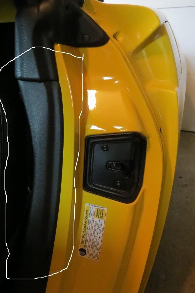

The actuator in my drivers door has gone out and needs to be replaced. Does anyone know of a "how to" to get the plastics off to get to the latch? I don't see anything external to remove save the one screw at the top, so I gather they just pull off, but I hate to start pulling on things without knowing for sure. The plastics in question are the ones circled here

You have to pull off the sill plate piece first, just carefully pull straight up to you unclip it.
Then the upper piece in your picture, again they pull straight out. I use interior clip removal tools with a thin towel behind it to not scratch the paint.
Then you remove the lower piece in your photo, just pull straight out. You can feel where the clips are when you pull.
Behind that you have weather sealed plastic to remove. I just cut the sealant with a sharp razor while gently pulling on the plastic while being careful not to tear it. It's sticky, so try not to let touch anything.
Then you can unbolt your latch by removing the two screws in your photo.
Then you will need to remove the plastic on the latch to access the pull cables.
Then remove the pull cables and replace your latch.
It's not hard, just takes a few minutes.
DJ

Success! There's a couple hundred in the bank

It wasn't so much getting them to work as having to realize the cables need to lay horizontal to the pieces they connect into. I fooled with them for 10 or 15 minutes trying to get it all to work right and get the cover back on with the cables coming out vertically from the mounting holes. Once I laid them down, it all went right together.
I actually took the car to the dealer last Saturday and after waiting an hour was told the one guy they had that could work on it was off that day. After looking around a bit and the help here, I figured I could get it done. #Winning!

Glad to hear you hot it done, I haven't had much time at all this year. I need to source a replacement motor to repair these latches.
Inside is a 12volt motor (less than $10) that runs a plastic lead screw to unlatch the the two stage lock.
You can drill out the two metal rivets, and then tap them for an 8-32 screw.
Replace the motor and put it back together. Save yourself a few hunfdred bucks.
Each company I have contacted does not have a direct replacement. Hopefully I will have some more time this summer to get this done.
DJ
