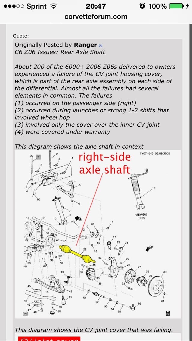

Default I'm borrowing this from one of the members on here
Found this very interesting
Could it be true: what the Most hp/tq I can get out of these axles , I know my mistake was traction control was left on :
To 2006 z06
