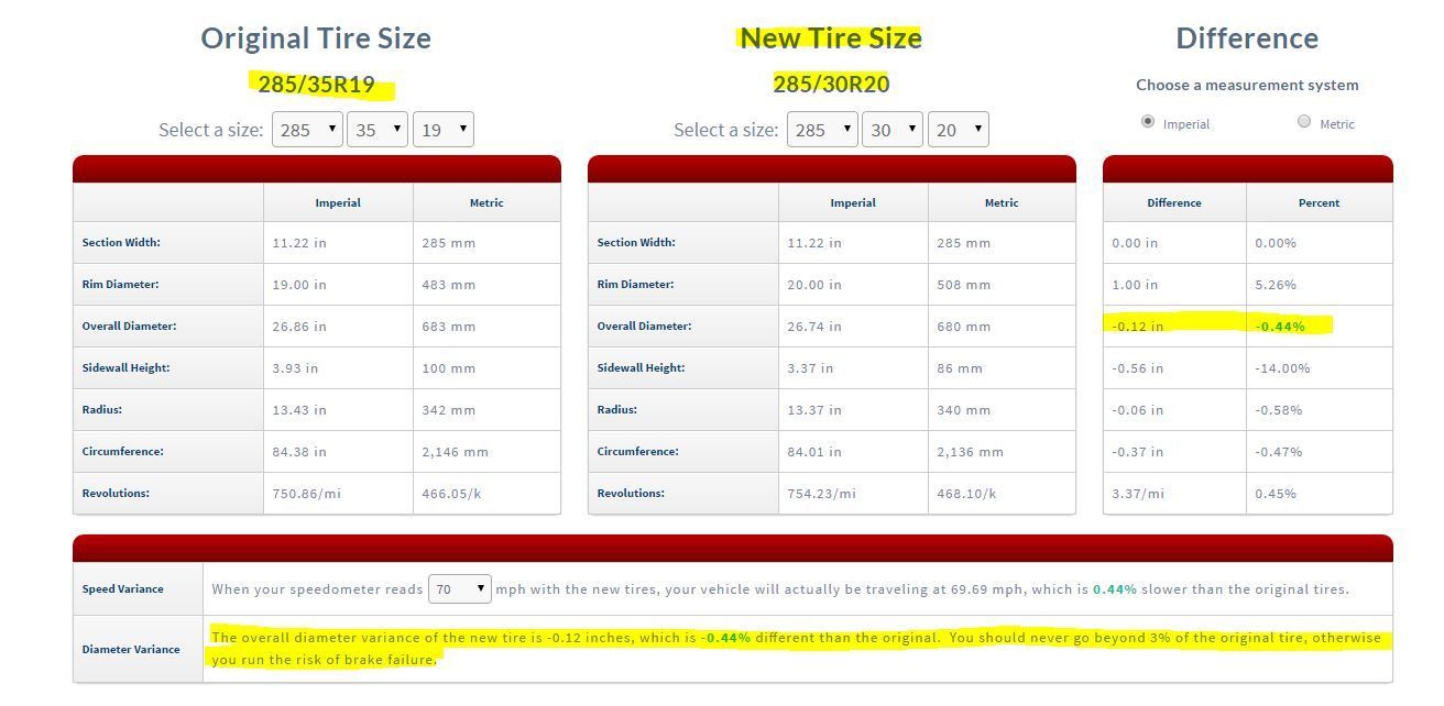

So that link provided to compare tire sizes is nice...If I look at it correctly the suggested size on the OP's 19/20 setup, if he runs (and what I guess I would run when i do this) is...
245/35/19 front, and 285/30/20
here is what the site says is the diff between the OEM 19's and the new 20's with the suggested size 285/30/20
To Larger Wheels installed. Need my acceleration back!

Now the huge note, the 1" larger, lower profile tires are not the exact same OD sizes as the smaller OEM 1" rim smaller tires, so the speedometer will be slightly off.
From 285/35/19 (OD 26.86 in), to 285/30/20 (OD 26.74 in) tires
When your speedometer reads mph70 with the new tires, your vehicle will actually be traveling at 69.69 mph, which is 0.44% slower than the original tires.
Thanks Dano! - makes sense now on the suggestion that C7 Z51 rims in 19/20's will clear the Z06 BBK for those of us who choose to modify on base/Z51 cars.

Just checked fellas. I have 245-35-19 up front and 285-30-20 rear. So now that we've cleared up that I have the recommended tire size, any other ideas why I'm dragging? No other mods have been done to the car. I was asked about offset. Where can I find those numbers on the car? Also would still love to hear an opinion on the 3.42 setup. Also, any other benefits to resetting the speedo other than it being off by a few clicks on the display?
