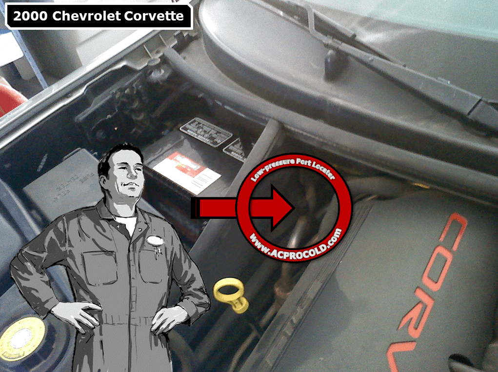

There are 2 fittings on the A/C lines, One big (high pressure and one small, (low pressure.)
Each has a plastic screw on cap cap. remove cap and look inside, you will see a pintle. push down on pintle with screwdriver. KEEP FACE AWAY! If nothing comes out, you lost your charge.

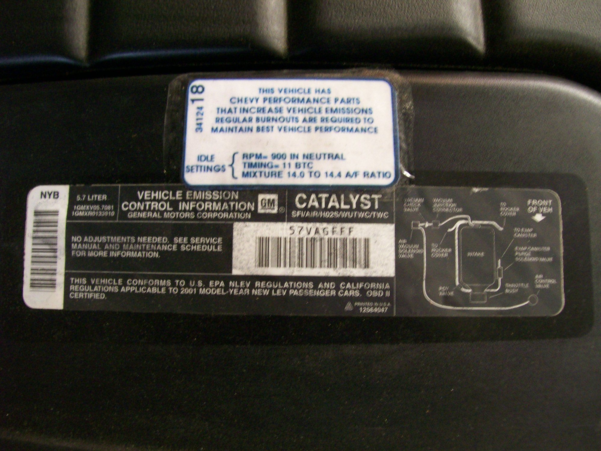

Every car has a black sticker with the quantity of freon needed fo that application.
