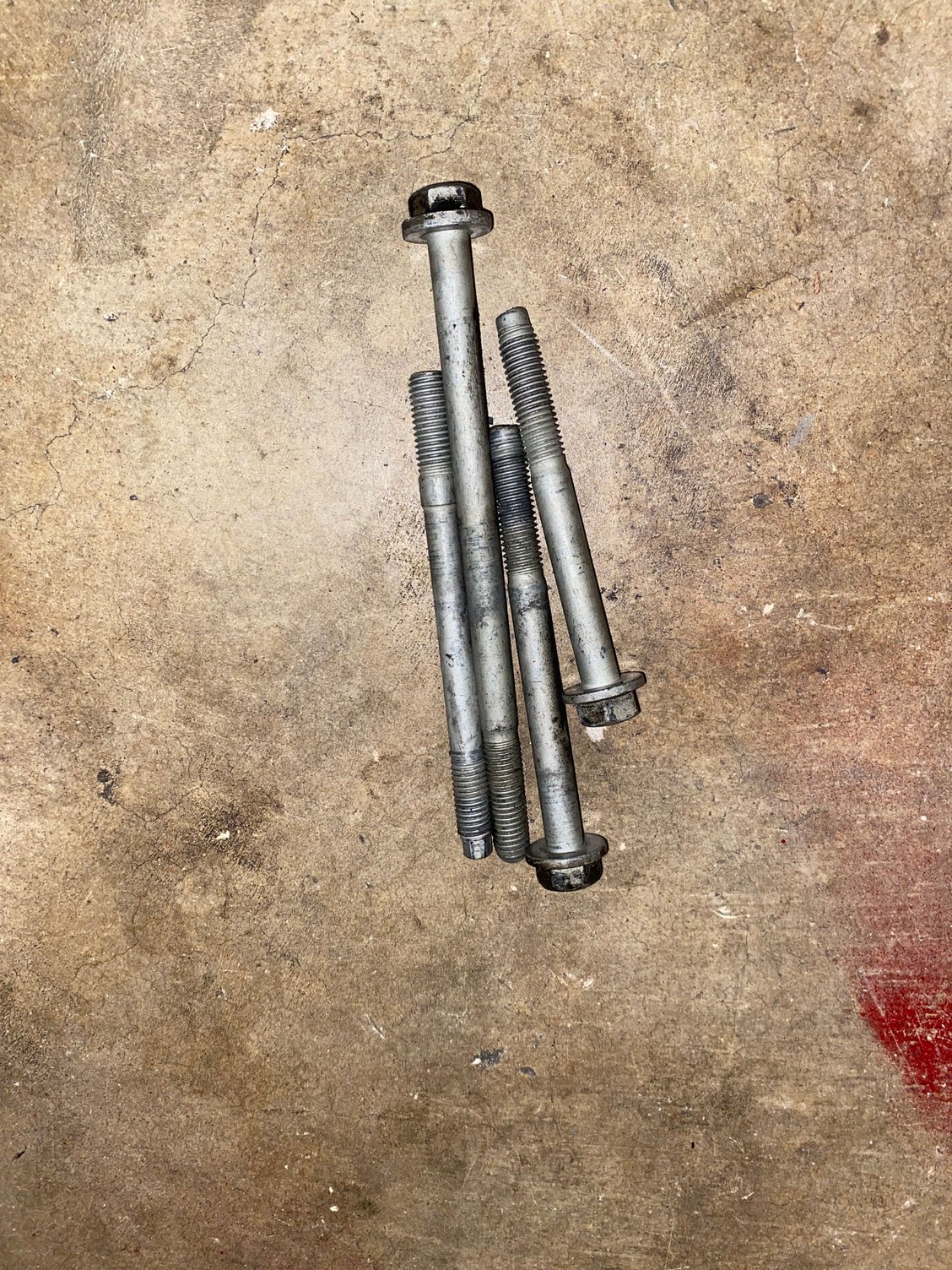

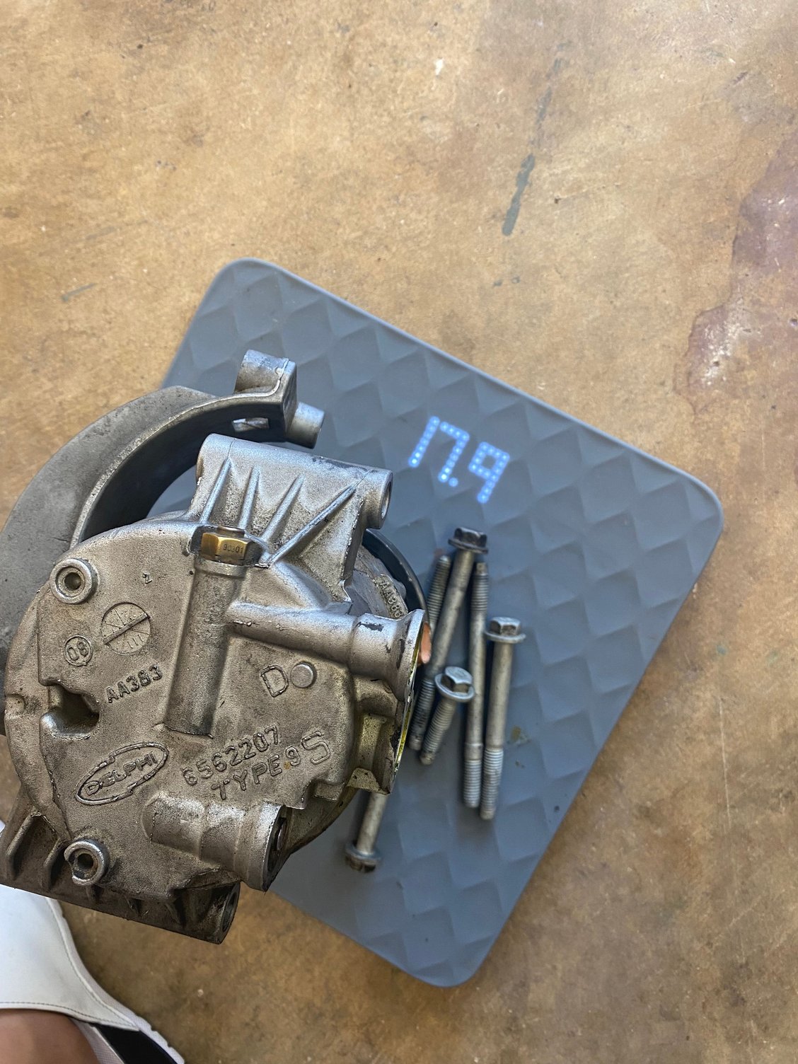

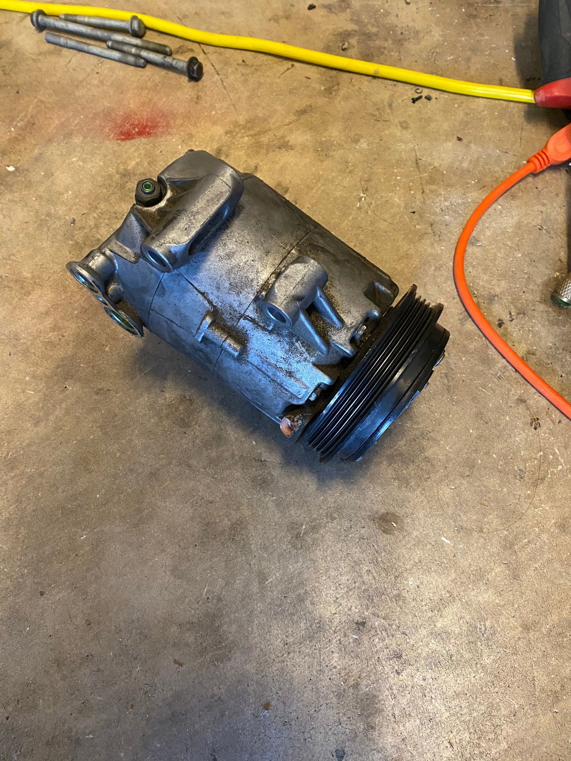

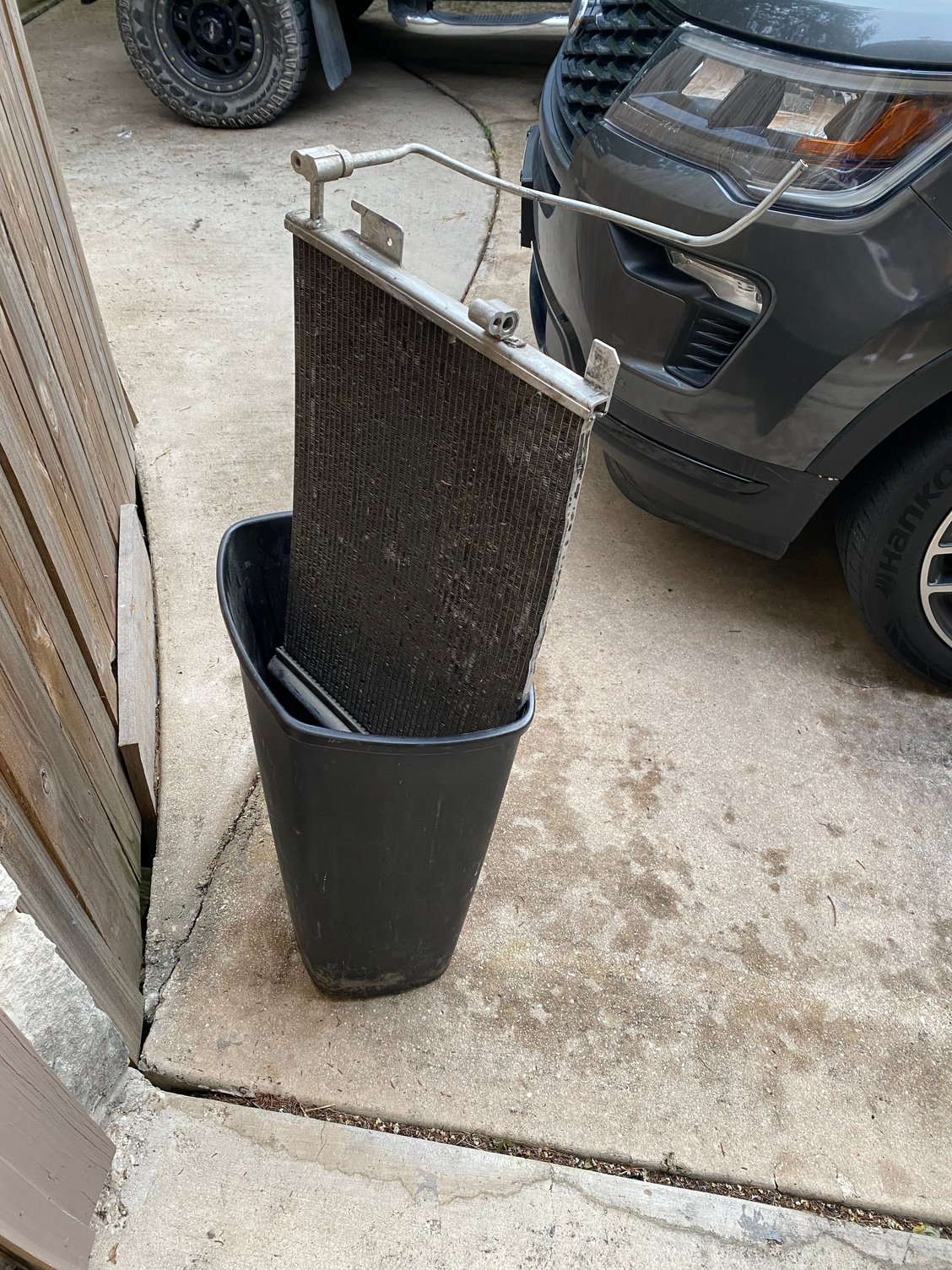

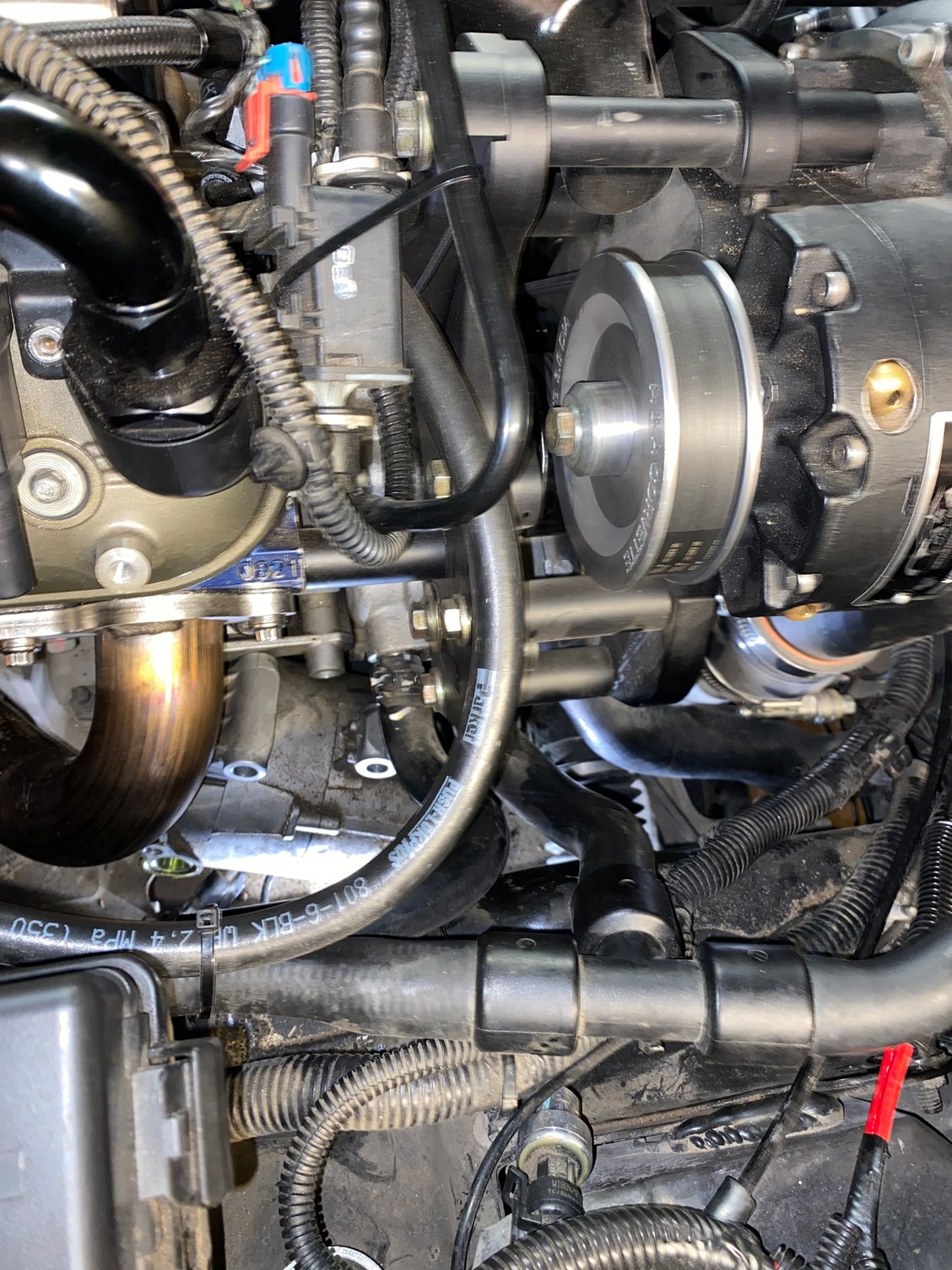

I’m bringing this old thread back to life. The ac can be removed from the top without dropping the cradle, removing water lines or even removing the pass tire. I also have a supercharger and inlet piping to contend with. I just got done removing mine on my 09. I took the condenser and lines off first. It was easy using a regular 13mm wrench to loosen the bolt holding lines on the compressor. Once loose turn it by hand the rest of the way. With those out of the way, take a 15mm and start on the top two bolts. The bolt on the top front is stupid long as is the stud next to it. You will have to turn the compressor to get those bolts completely out. The bottom two bolts you will have to feel for and using a ratchet and 15mm deep socket get them out from the bottom of the car. They will come out completely. Next remove exh manny bolts and collector bolts and move exhaust aside. It will wiggle out the top. Then using a 15 socket remove the bracket and pulley too. Pretty easy. Mine was working absolutely fine just never used it. The few times I did temps would jump from 180’s to 220. Not happening for me. I didn’t buy this car for comfort. Hell the cam alone rattles my eye ***** out of my head. Good riddance. It’s not much in the way of saving weight but the engine runs much cooler now. The condenser was absolutely filthy and caked up. That and a huge Intercooler wasn’t helping. Oh well. It’s just a base model anyway lol.
