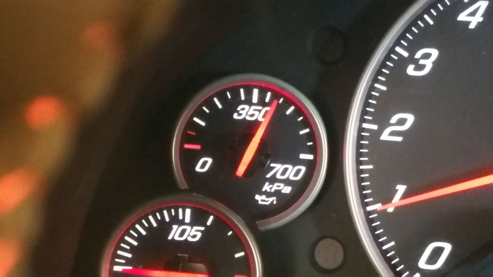

yeah i agree. I did heads, cam, and everything else. put it all back together and drove it a bit. On my way home, noticed the gauge flat lined. chose to drive it another 30 seconds home. I was terrified cause obviously I just was in there and had the pump out.
scanned it and got this P0523 which will not turn on the engine light. turns out it was just the sender phew
