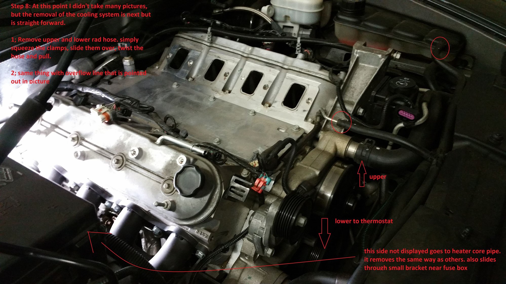

New radiators are cheap. Make sure you get all the air out of the system when you replace it or it will over heat on you.
I use the vacuum system to refill, works great.

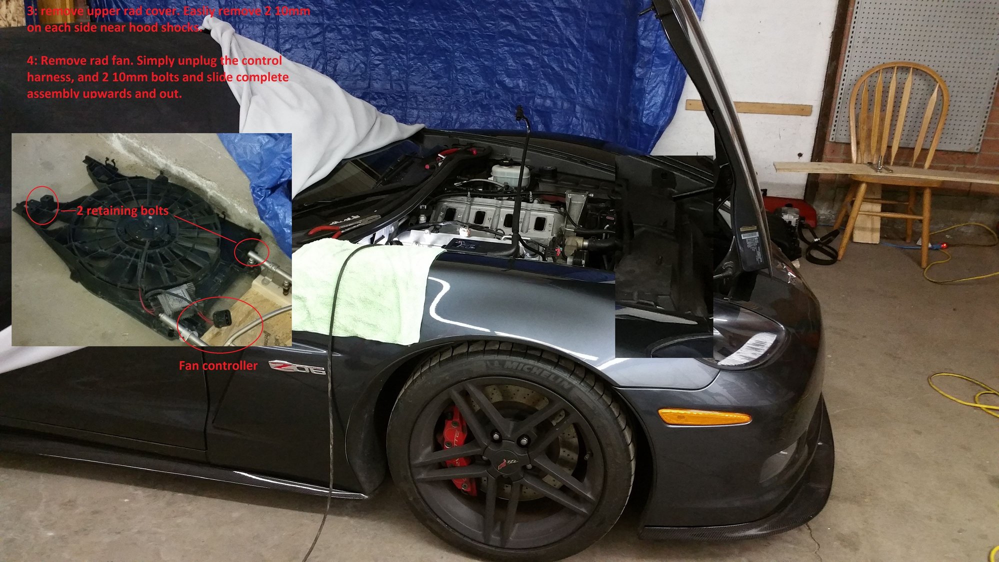

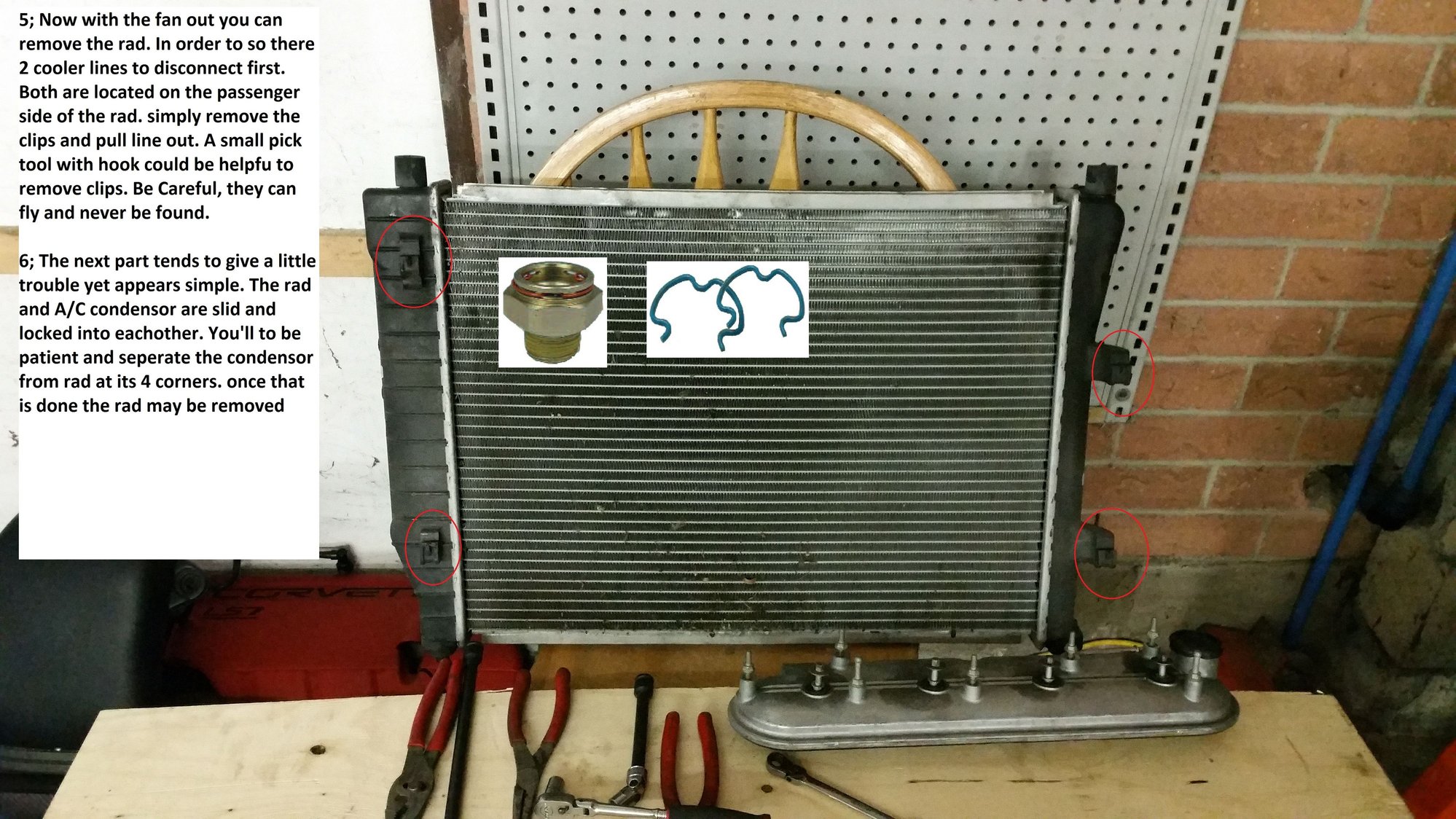

The hardest part about it is un-clipping the rad from the condensor as they slide into each other. The fans come out pretty good, 2 bolts on opposite ends and unplug the module. and if you have the cooler on the right side use a pick tool
