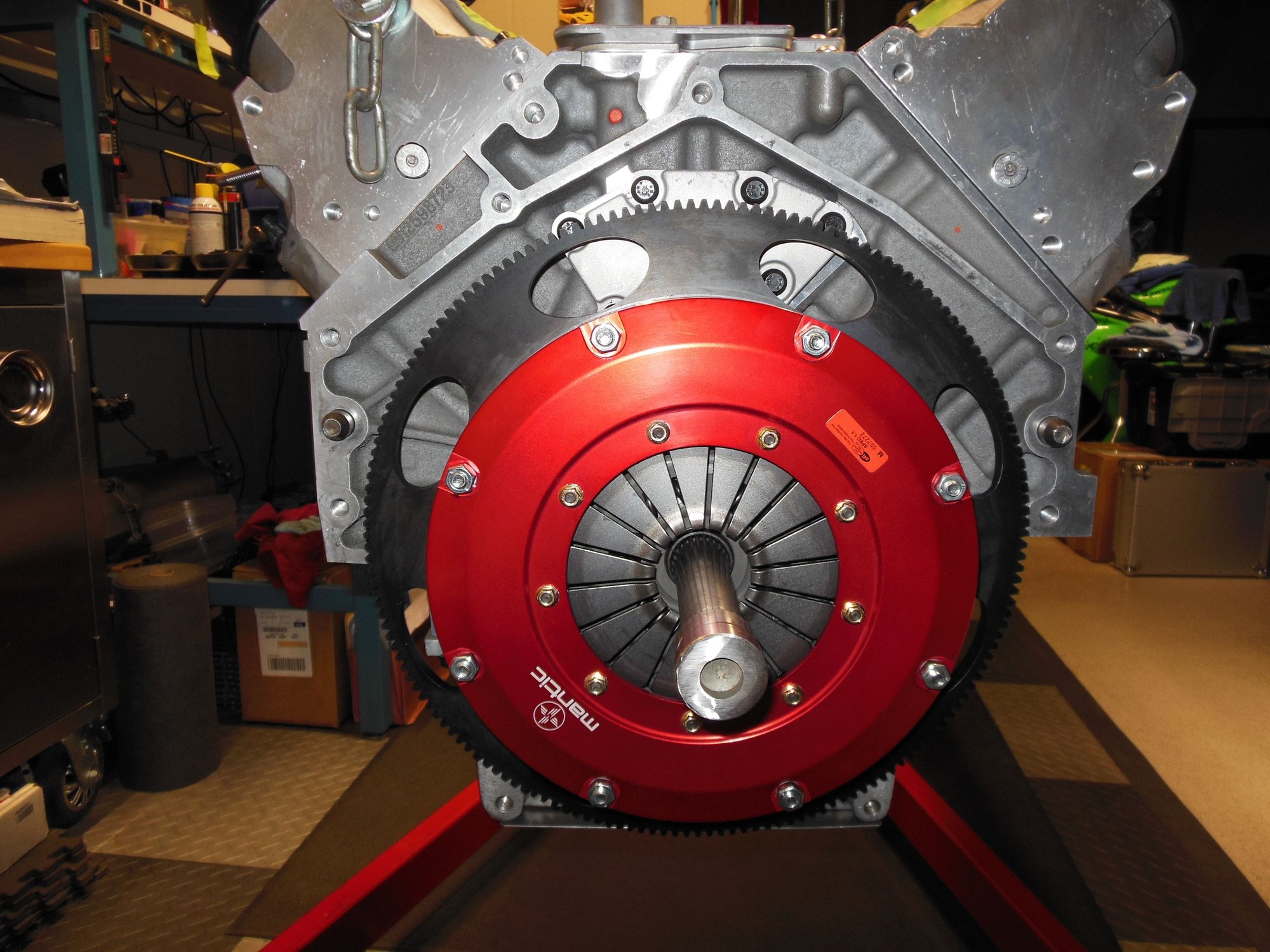

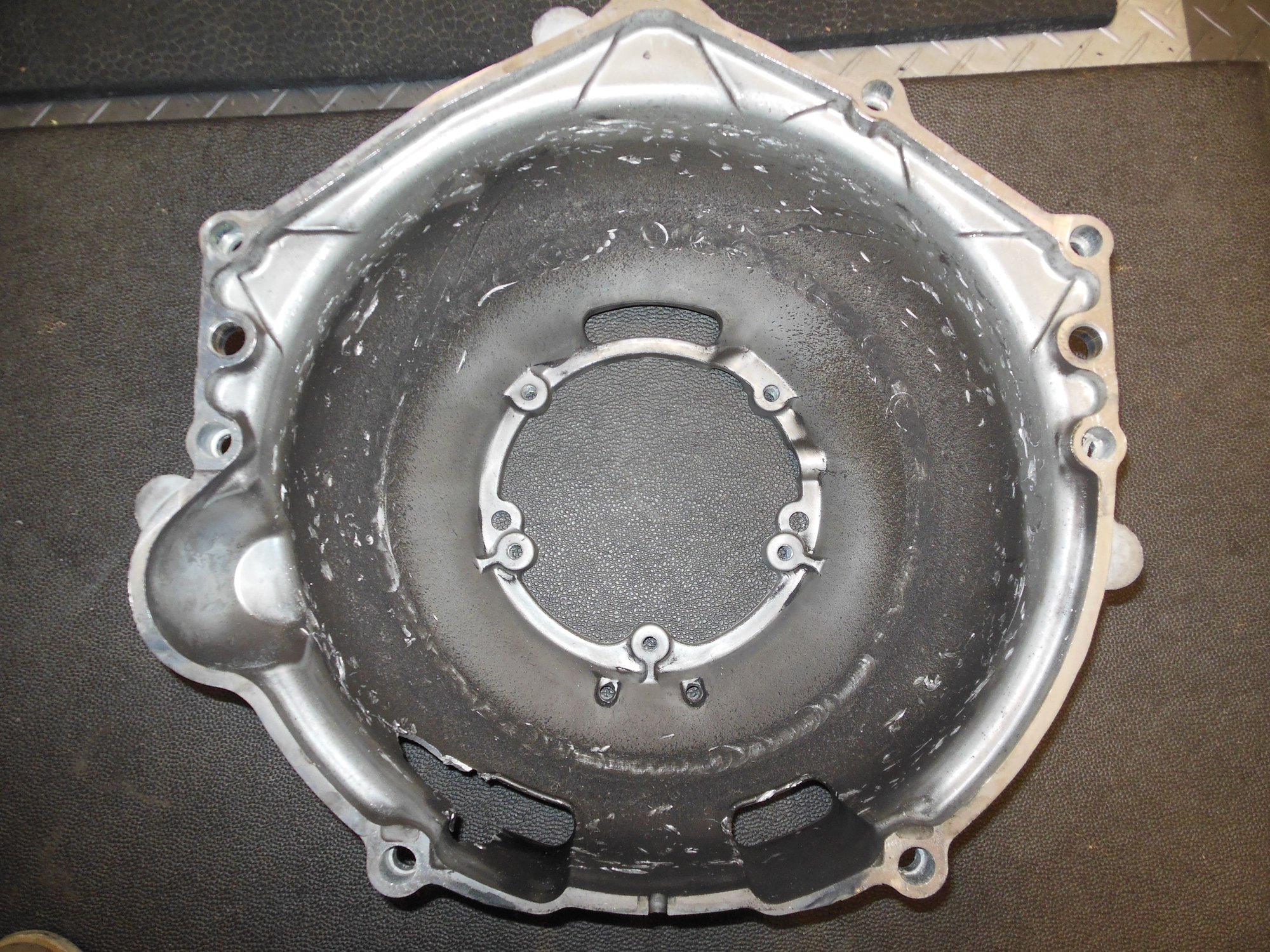

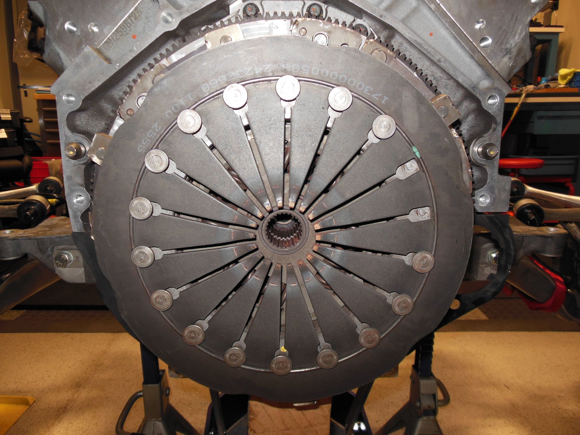

Katech LSX9 zr1 clutch and flywheel combo installed on a LS7.
15,000 miles. No abuse. Track and street car.
Two of the rivets failed and destroyed the bellhousing, flywheel, starter, and right header. Other people have had ZR1 clutch failures on modified engines.
Installed a Mantic 9000 dual disk. Great clutch.
