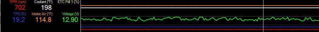

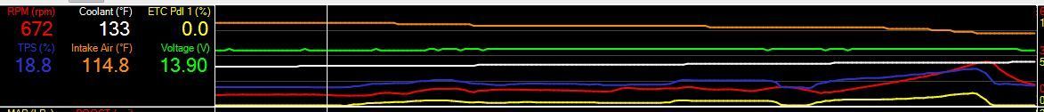

Here's some screenshots on mine. Again..can't say 100% it was the plugs, but I don't really know what else could have done it. Same alternator and battery. Weird coincidence that IAT was exactly the same.
AC Delco's, stock GM wires
TR6's, MSD wires
TR6's, MSD wires
maybe those msd wires. don't hear good things about them at all
