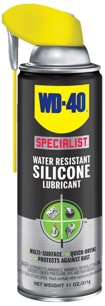

As for the door latch itself (and other latches like the hood latches), just spray them with some silicon spray once in a blue moon to loosen up it's internal dried out grease parts so the internal parts can move freely again.
