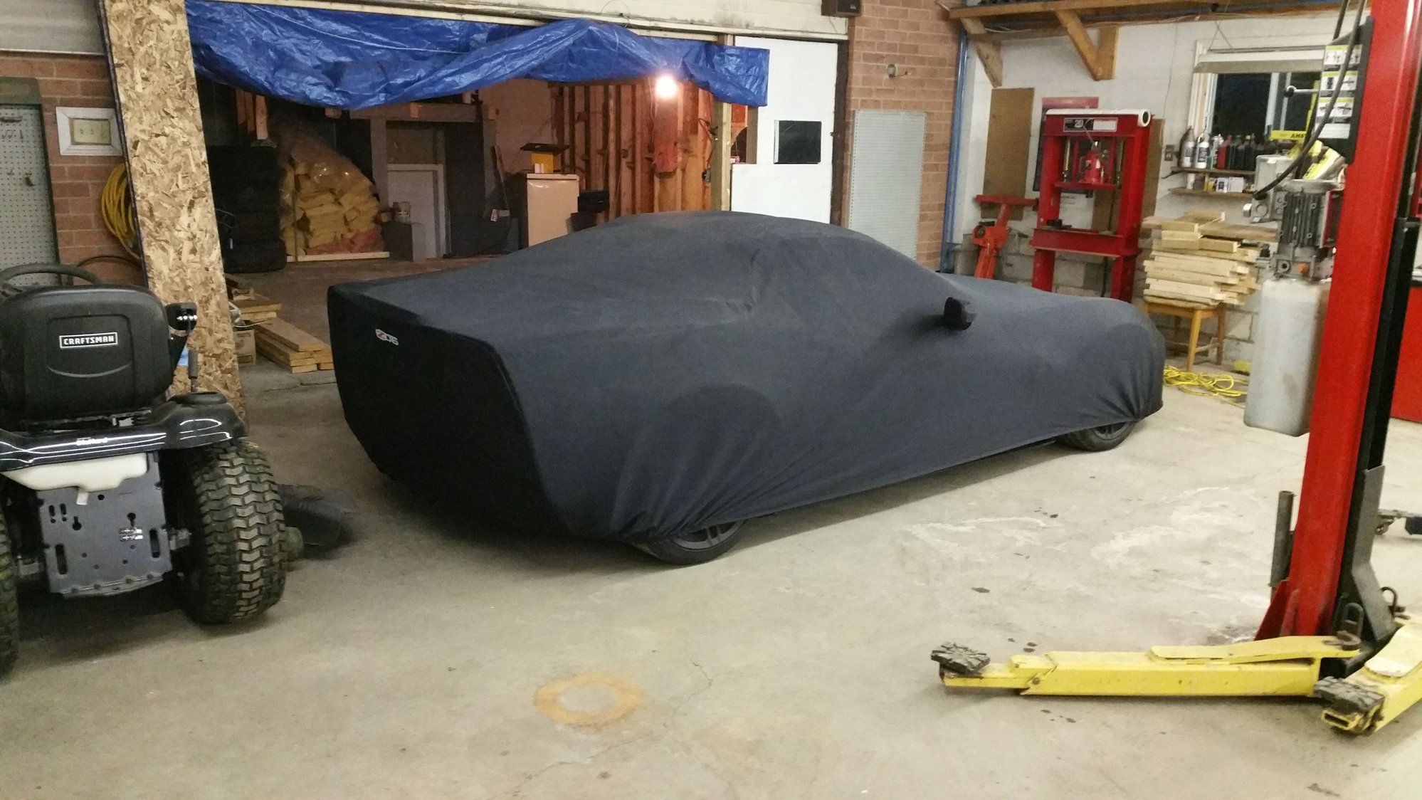

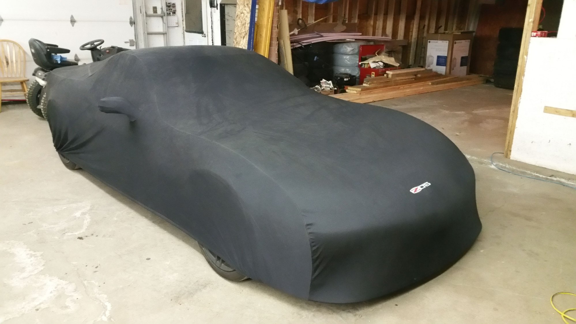

Everyone does their thing but pure anti-freeze is over kill. 50/50 mix of water and antifreeze is good for -37c/-34.6f and that's the way the car comes shipped at least in canada.
Winter washer fluid is good for about the same and that's all I use year round to be safe that none of our 3 cars ever get caught by surprise because it would likely be forgotten.
I'm not sure I'd fill the gas to the rim. It's not at all good for the evap system and I kinda rather have little to none so that it get's nearly a full tank of fresh gas in the spring.
I agree about getting the oil change then store it with brand new oil for the winter with no start ups. keeps condensation out and engine wear down.
If the garage has power yes a "smart" automatic battery tender would be better then removal. cause even removed you should have it charged occasionally.
Don't worry about flat spots, almost an urban legend at this point.
Nice soft cover like the GM satin stretch is easy on the finish and looks great.
mine's been away for 2 weeks unfortunately
