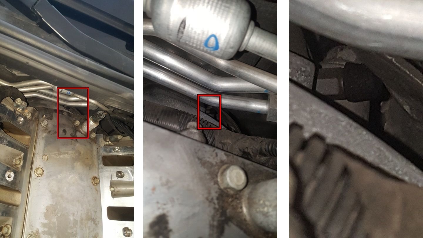

Wanted to add pics from the manifold removal method. Followed helpful removal guide from Peak Speed Shop , On this particular 2006 LS2 I was still not successful in getting functional access to the bleeder. I'm not saying it's impossible, but I was not able to do it, and could not even get my very thin fingers close enough to touch the cap on the bleeder. Most of the problem came from the AC lines, which run overtop the bellhousing and leave only a very narrow opening. I guess I will go with the "Ranger Method" until it is time to do an actual clutch job.
2006 C6 LS2 Clutch Slave Bleeder: From the front of the engine with the intake manifold moved out of the way, the slave cylinder bleeder can be seen protruding out of the bellhousing toward the driver's side at the ~1 o'clock position. What the picture fails to demonstrate accurately is depth, it is a long way from the front of that narrow opening to the bleeder itself, I could get my hand up to about mid palm and I was still nowhere near it.
