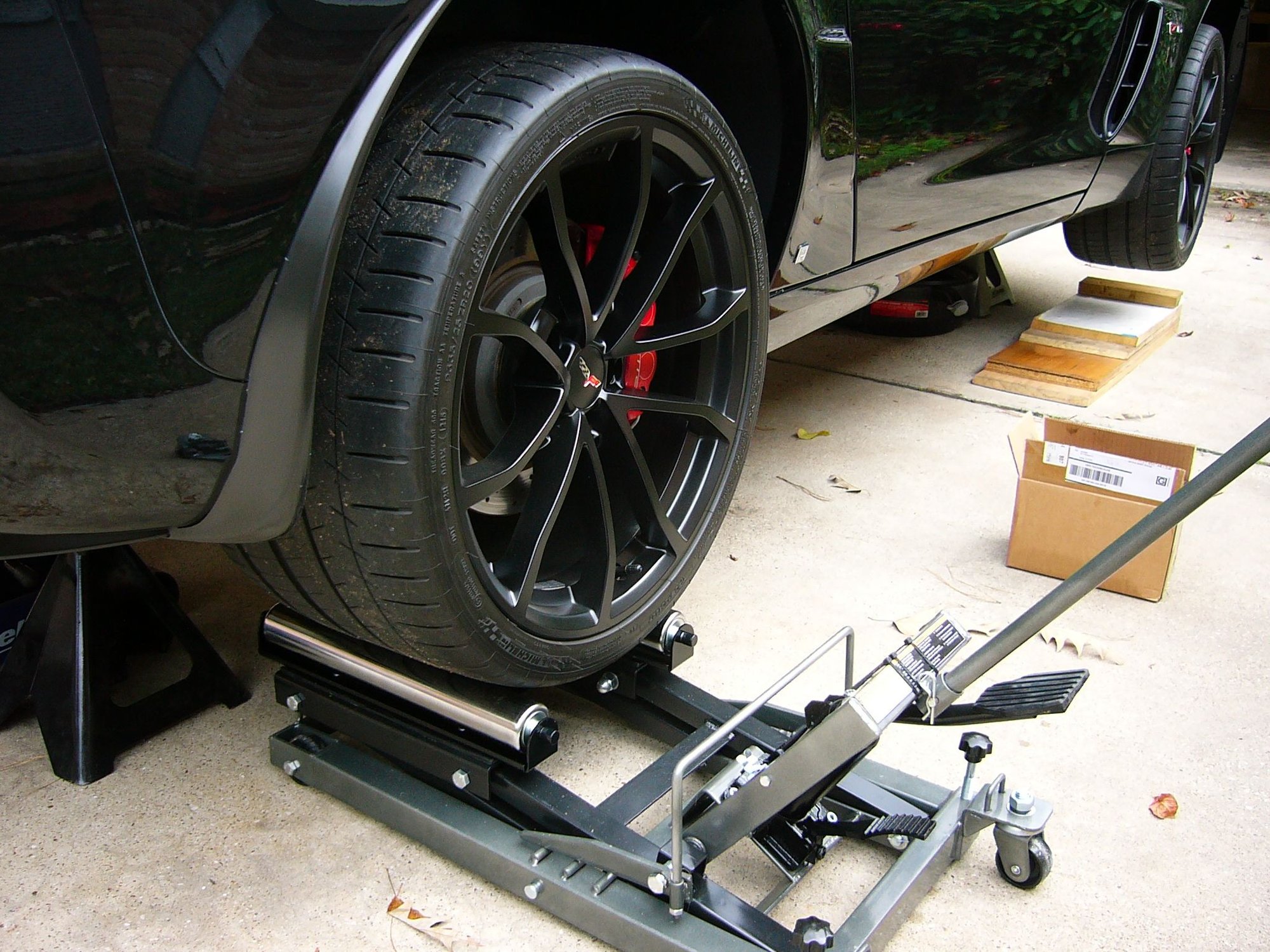

Here's a gizmo I put together to make it easier to R&R my wheels. It's a hydraulic motorcycle lift with rollers mounted on the lift arms
It makes removing and mounting wheels very easy and keeps the wheel from hitting the caliper and/or rotor.
Here's how it works:
1) Put the wheel on the lift
2) Raise the wheel and rotate to match the studs
3) Roll into place and install the lug nuts. No sweat and keeps the wheel from banging the caliper or rotor
To remove a wheel, reverse the process.

Very nice,
Since I have limited space I am in the process of making an adapter for my floor jack to do the same.
My first was just using some old skate board trucks which actually worked quite well.
DJ

Pretty neat set-up for sure. I still do it the old fashion way, lifting the wheel onto the studs. With the bigger wheels, your idea is a back saver for sure.

It is not just for saving your back, I have about 8K invested in my wheels, the inner barrels come in to a smaller I.D., and it is easy to scratch them if you are not careful.
Also, if you have CC brakes it helps as well.

What was your source for the rollers?
Thanks.
DJ
Please let us know what you come up with for your floor jar adapter. I'm looking for ideas.
Thanks.
Thanks.
Do you have access to a machine shop, or would easier materials to modify work better for you?
I have to go on a business trip till Feb, but can come up with something when I get back.
DJ
DJ
I do have limited access to an automotive machine shop but I don't think that there is a lathe there if that would be needed. A solution that a guy could accomplish in a home garage without welding would work well for me although I do have friends that weld so that's not insurmountable. Something like this would give me an excuse to get together with them.
I have the Craftsman 2 ton aluminum floor jack with what appears to be a permanently mounted jack pad.
Thanks for sharing DJ.
