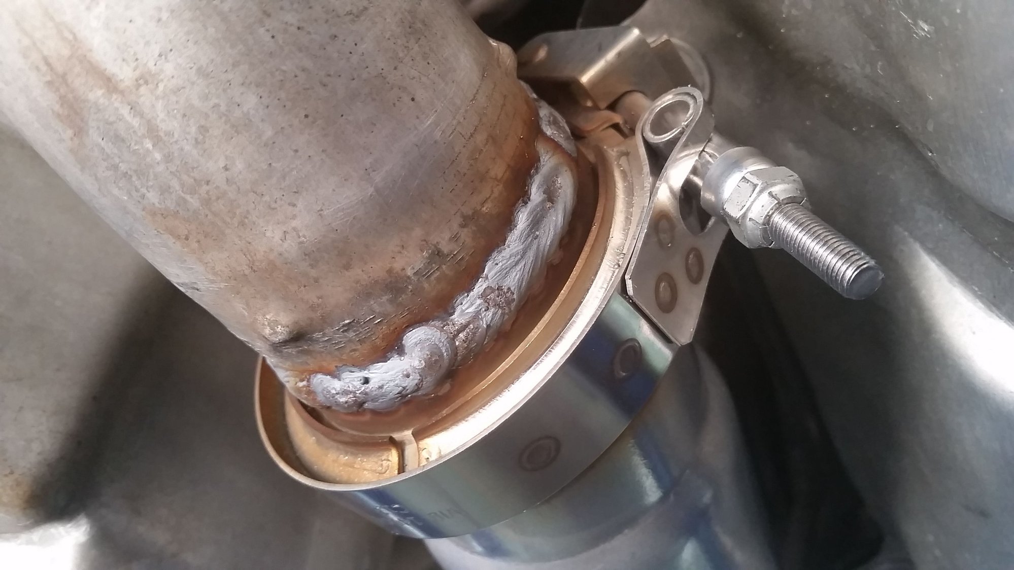

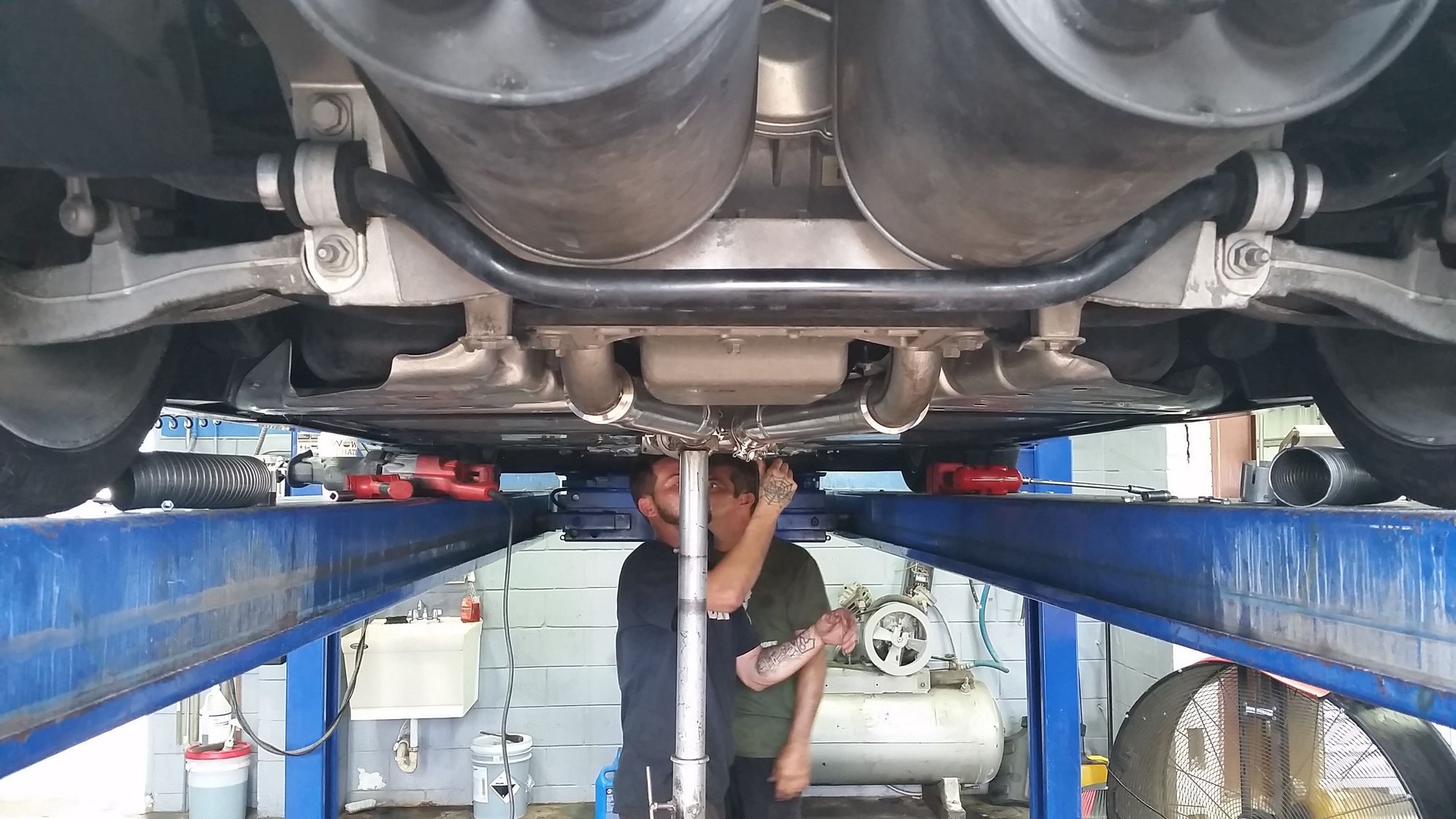

Kooks headers /Cattless X all three coated.
I also had wrong pipes from x to axle back. Just no way to work and to long of wait for vendor to make it right.
Had to take it to shop to find a way to connect pipes to muffler. This is what they came up with. Not cheap but only hurt once.
https://www.pepboys.com/product/details/9974375/01632
