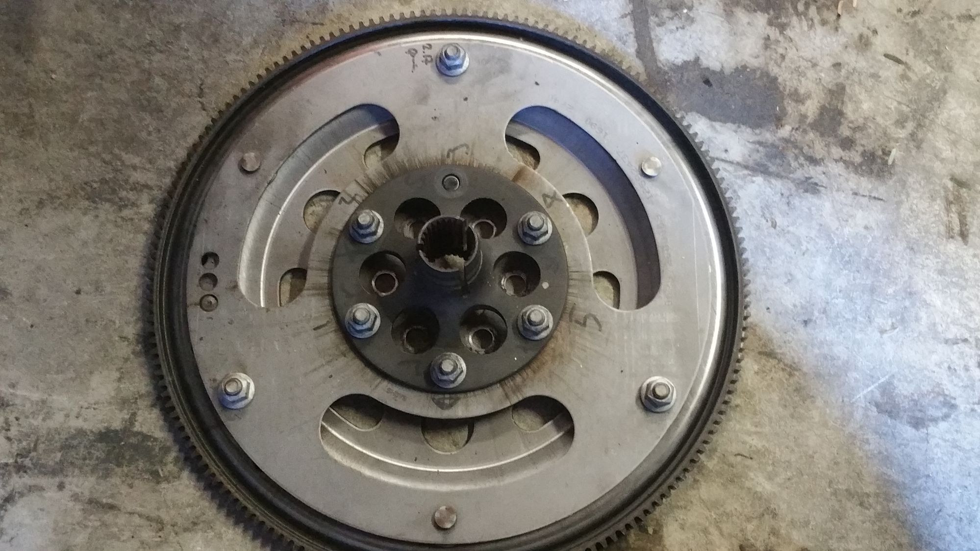

There's almost nothing that can actually go wrong with a flywheel on an A6 car as it looks like this:
With that many miles the more likely cause of the problem is the internals of the torque tube have worn out.
You still need to pull everything from the motor back though in order to fix it.

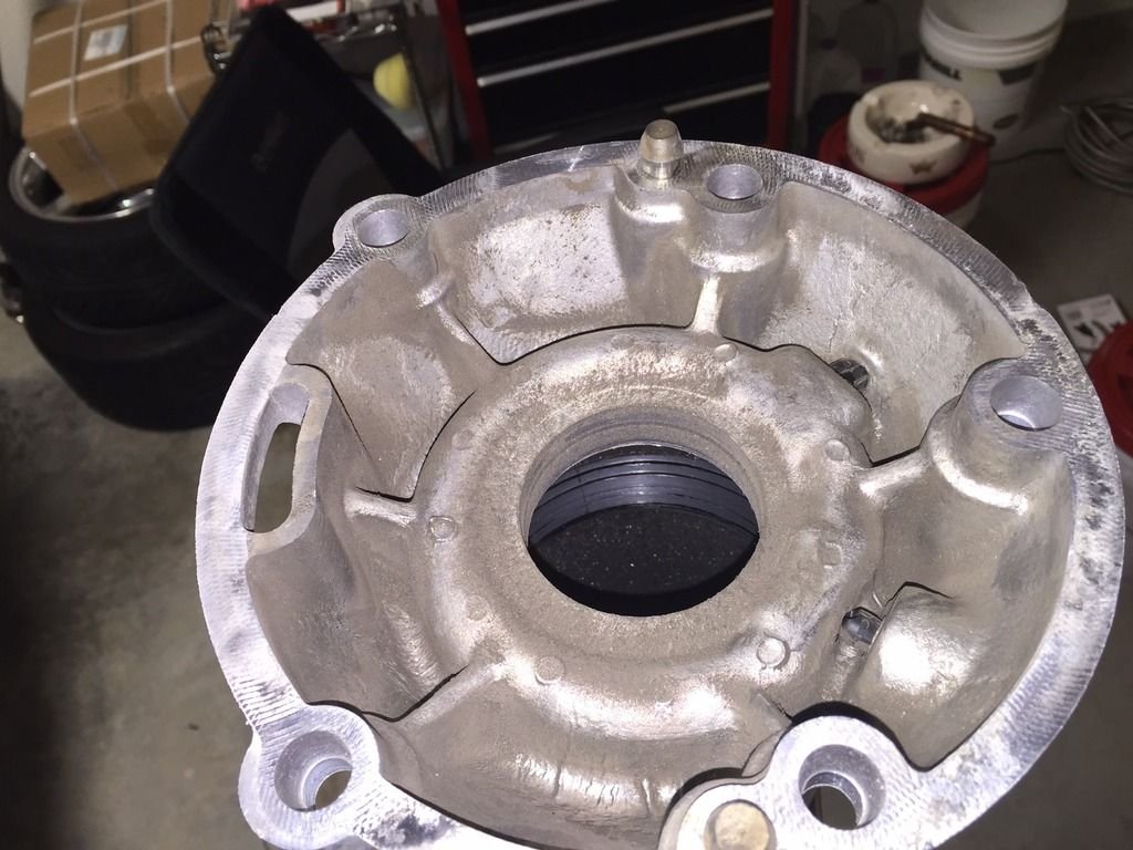

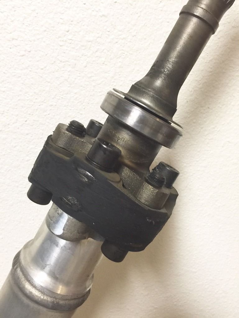

Default Damage Pics. Best course of action???
Two pics of damage.
What is the best course of action from here?

I'm not seeing anything I would consider worth of the description "carnage"
You need to figure out why the coupler was rubbing against the housing though. While it's apart you should replace the couplers and all bearings.
All the bearings in mine were absolutely shot by just over 100K miles.. so I would replace them while you have it apart

What supports the bearing in the end of the housing, where the "O" ring is located?
Old Jan 3, 2016 | 07:54 PM
schpenxel's Avatar
schpenxel
Joined: May 2004
Posts: 16,667
Likes: 1,209
From: Raleigh, NC
St. Jude Donor '15
The bearing goes there.
The O ring gives it a little bit of give.. but the bearing goes in that opening
That's why I told you to pull on that shaft and try to pull the bearing into that hole with the o-ring. It looked like it had somehow been pushed out in the video you posted (I'm assuming that was you anyways.. the names are running together right now)
