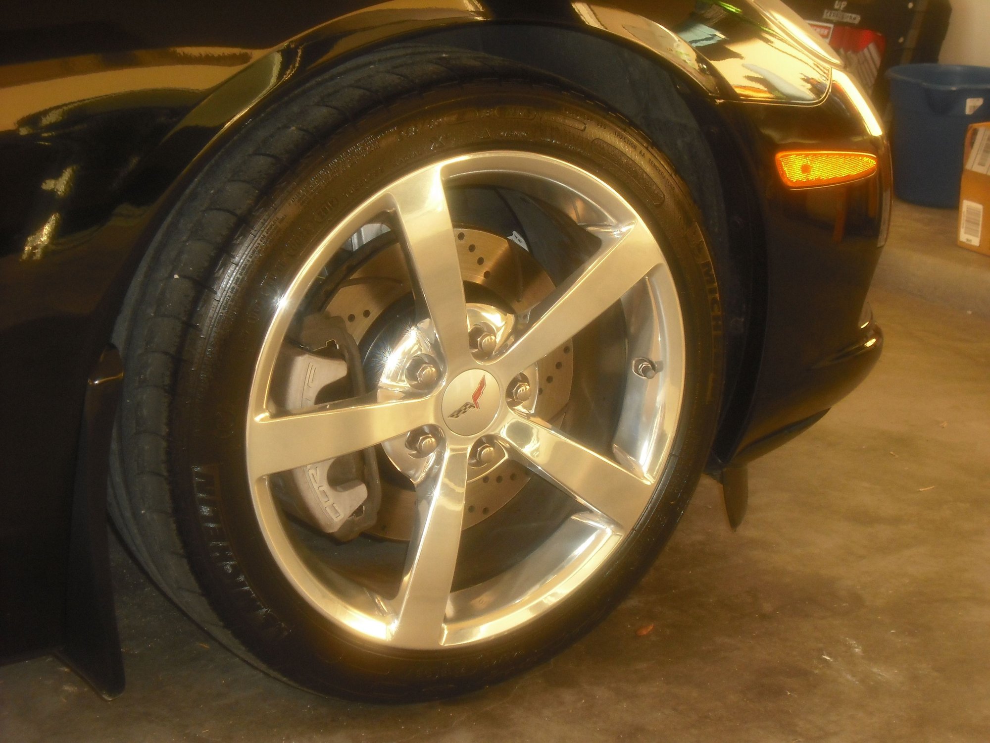

Here is a pic of bear erradispeed 2 piece rotors.
