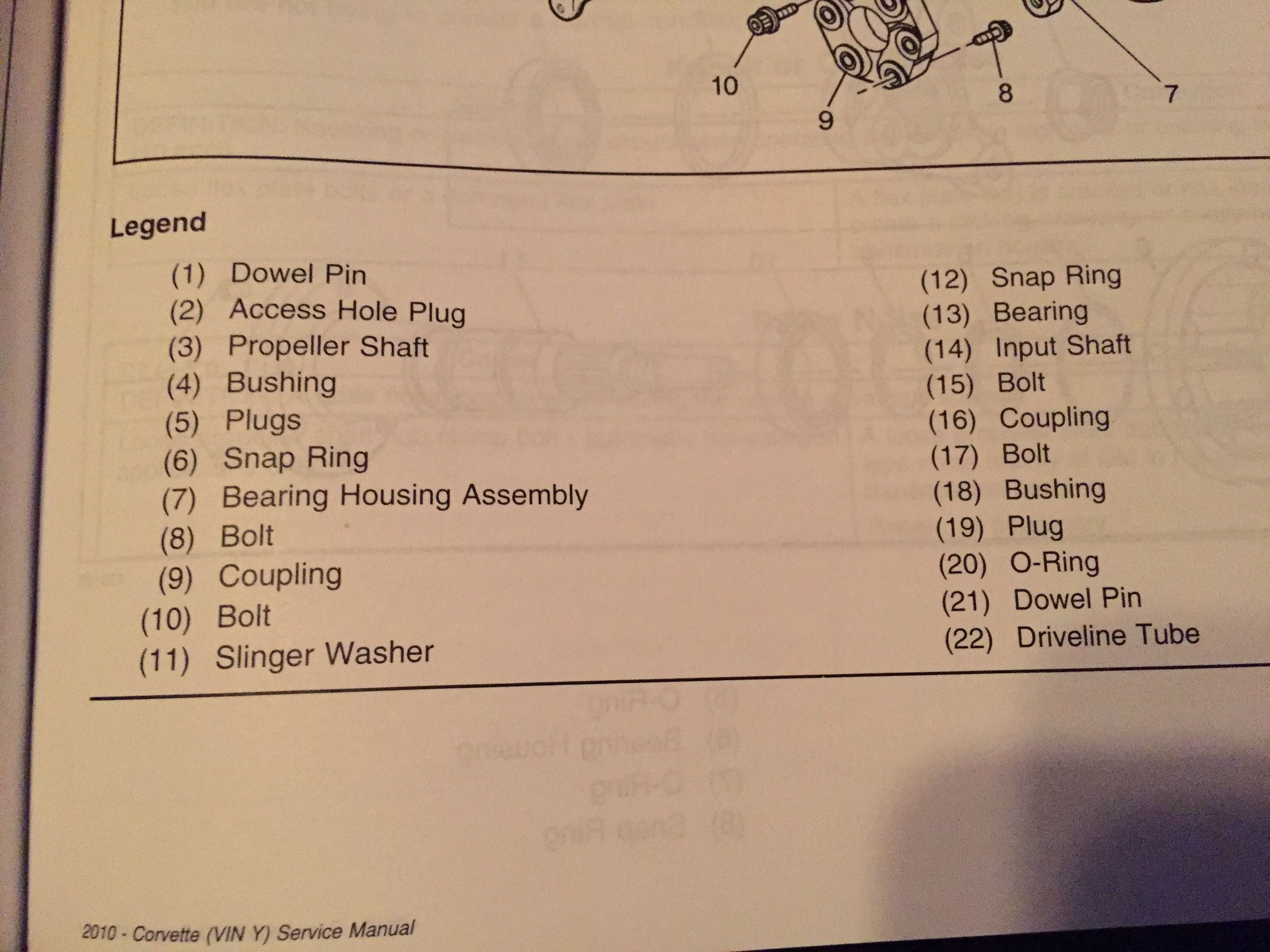

I dont have first hand on this one, but here is some info that may help if you dont have it handy. If for a 2010 but may help anyway.

Trying to figure out if the outer surface of the bearing(13) mates to the rubber "O" ring(20) in the tube housing. On mine, before pulling the shaft from the tube, the shaft wobbled up and down allowing the coupler to contact the inside of the tube. I did not detect any play in the shaft, in and out or along the length of the shaft.

I'm telling you, the bearing goes in the opening where the o-ring is. I've had mine apart twice. That is why yours was flopping around like a loose noodle
This is technically a C5 torque tube but the design is the same

This is very helpful. A rebuild kit is a no brainer. I'm concerned there may be damage to the bearing mating surface requiring me to replace the whole tube. schpenxel thank you for your help. Especially this cutaway image!

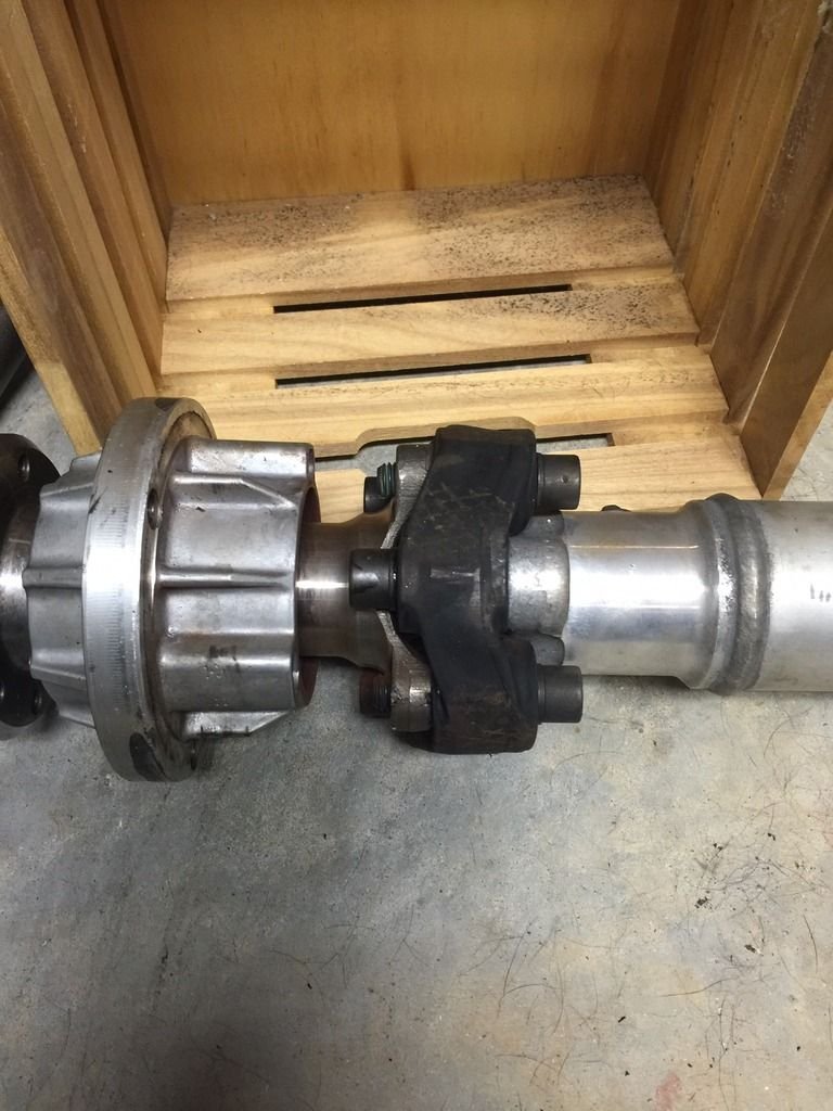

Default Do the couplers look right?
Wondering if the couplers look correct.
Old Jan 3, 2016 | 08:36 PM
schpenxel's Avatar
schpenxel
Joined: May 2004
Posts: 16,667
Likes: 1,209
From: Raleigh, NC
St. Jude Donor '15
Nope. They should be flat. Them being flexed like that is why the bearing wasn't in the right place
The question is why... looks like there was a lot of pressure pushing back on the input shaft. I don't know enough about how the A6 versions work so I won't be much help there
