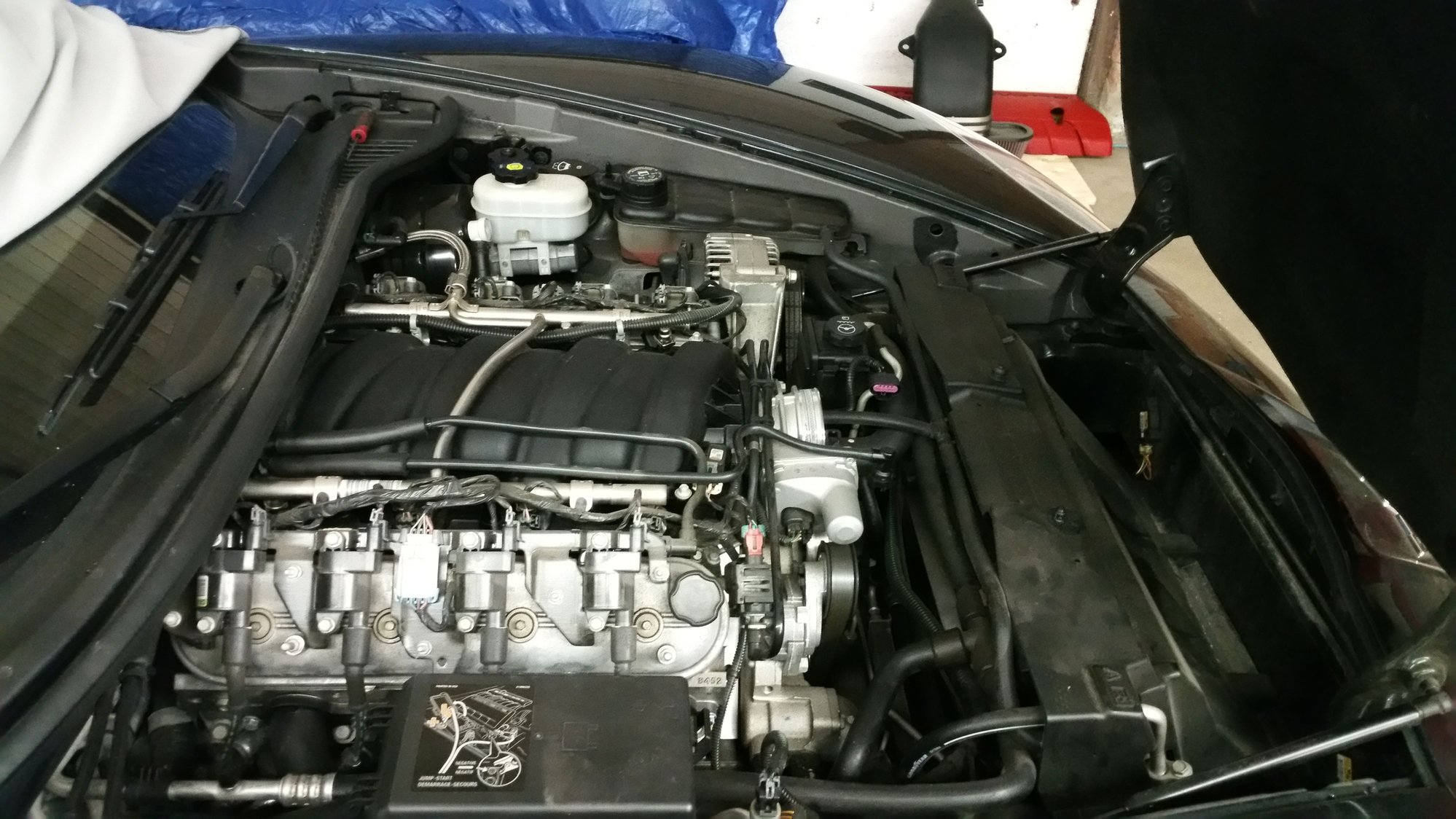

Not a pic of my car. Just found this on the web and circled the line in question.
What is it, and where does it connect? A pic of a C6 stock engine or anything would help. I can't find a pic clear/detailed enough to see where it goes.

Evap purge. Connects to intake, driver side, near TB. Evap solenoid goes Inbetween
you can see it on this pic
