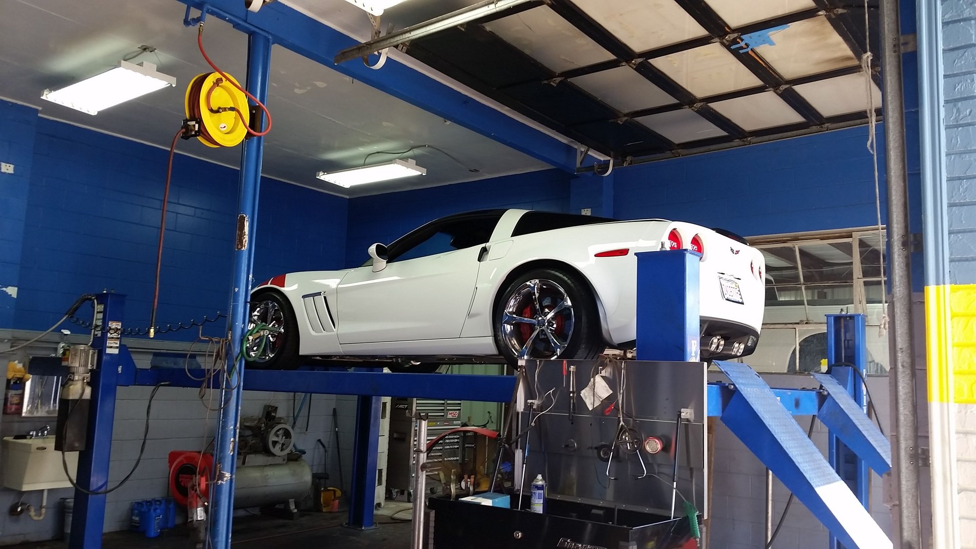

Kooks and cat-less X W/NPP --
Dyno-tune, Toggle switch mild/wild makes this old man young again
