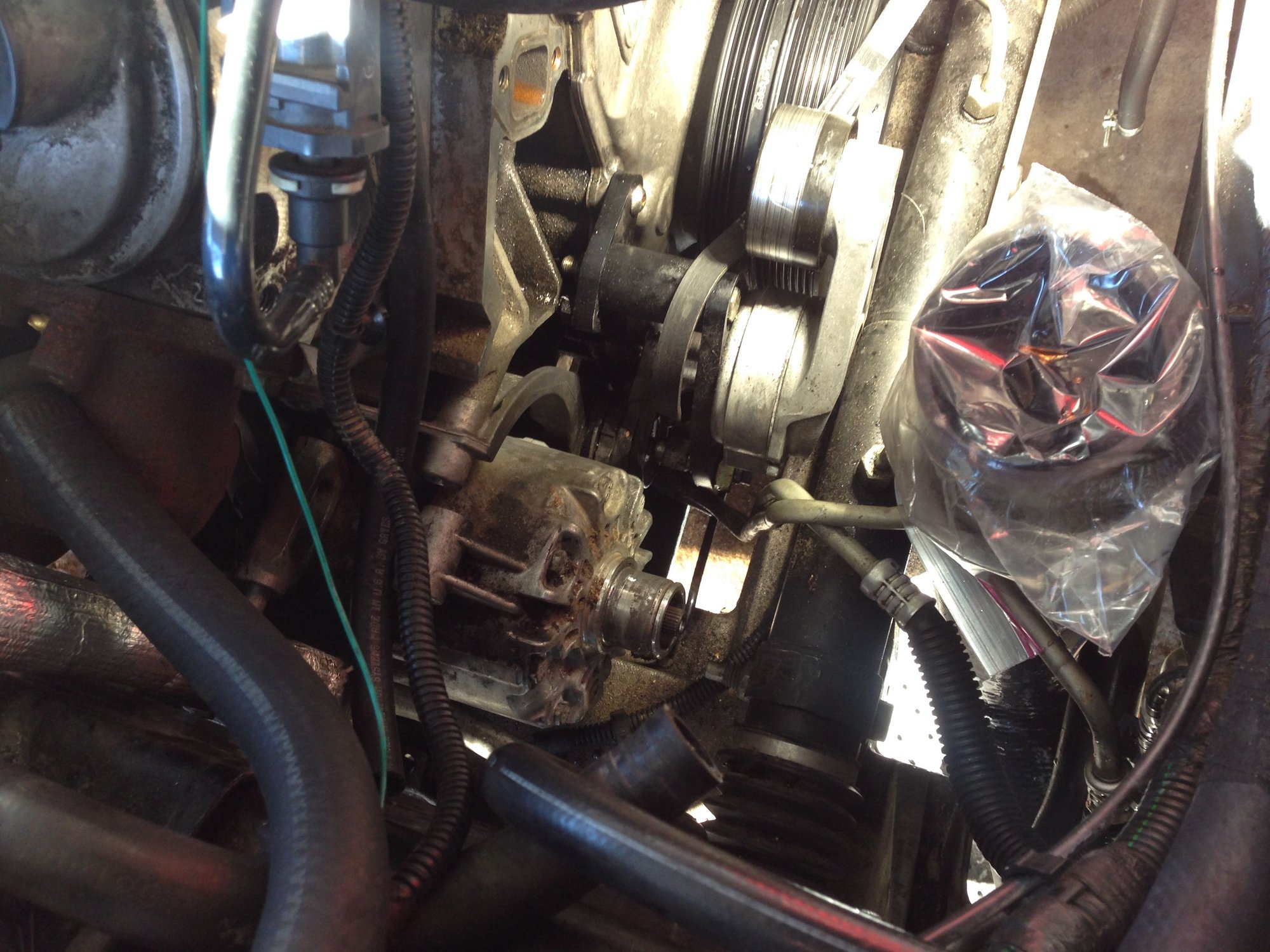

I've pulled it out towards the front with cradle in place. It's a bastard, very tight fit.. but it will come. Took some jerking if memory serves.
Posted pics in C U's thread a day or two ago if you want to see them.

Sorry about that.. I tried to post them from my phone, I guess they didn't go through.
Here's the two I can find.. it's tight!

Thanks for the pics! In one of them, it looks like you removed the pulley. If so, was it difficult to do so? Looks like it's held on with a c clip.

I had to replace the clutch on mine, so that was why I removed it.. you don't have to remove it to get the compressor off thankfully
It was a royal pain to get off.. It's just a snap ring or two that hold it together but they are really tough to get to. With the correct snap ring pliers that are angled perfectly it probably wouldn't be so bad.. but I wasn't that lucky

If the AC compressor clutch pulley fell off - the od of the fit on the nose of the compressor is probably tore up.
Try using gap filling bushing adhesive with a new AC compressor clutch. The car in the pictures has headers and you will not get the compressor out if you have stock exhaust manifolds.

The car in the pictures is mine and was running factory manifolds.
