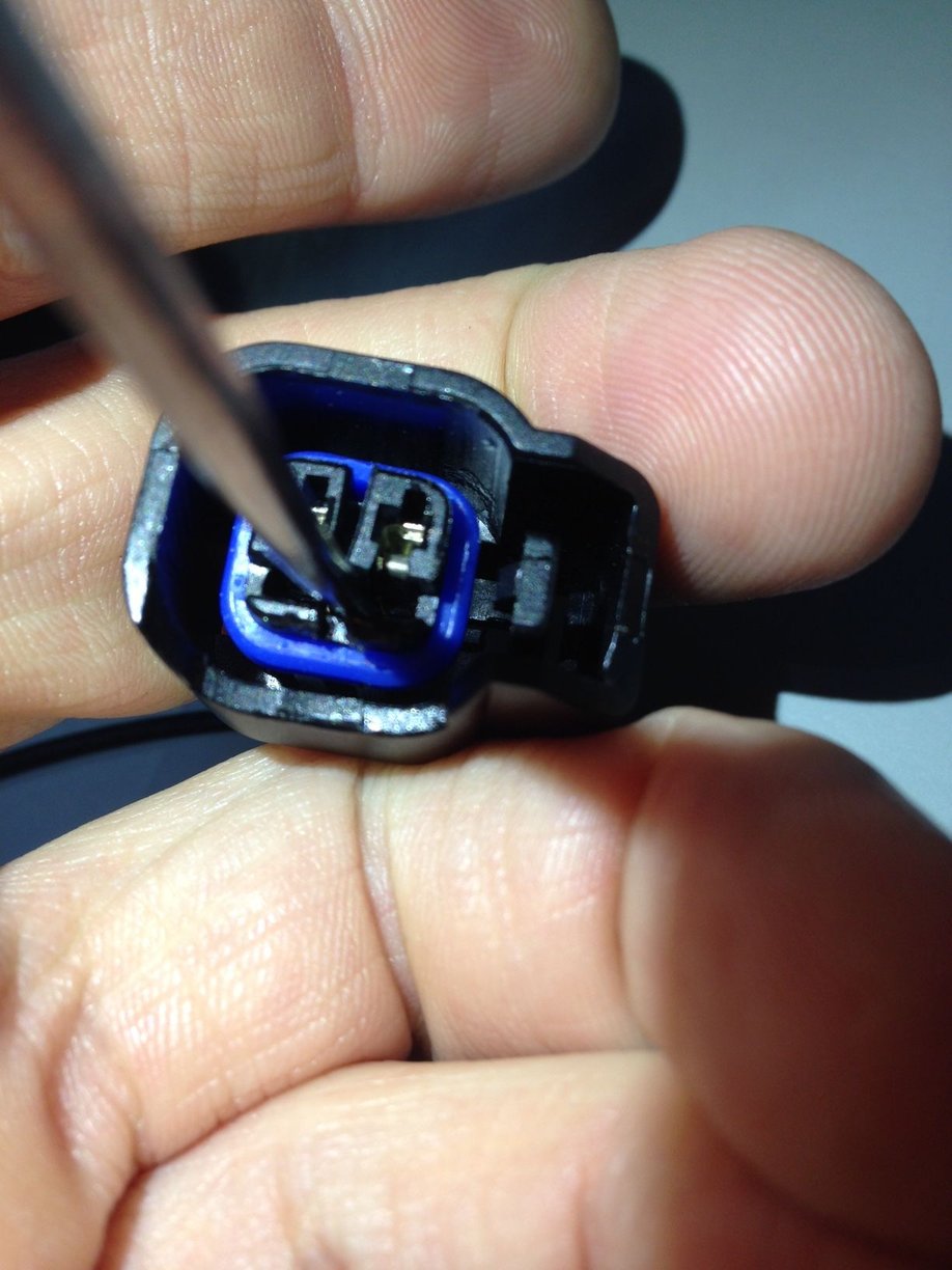

I haven't taken that particular one apart yet.. usually if you study the new connector & pin you can figure out how the pin "clips" in to the plastic connector and that will give you an idea on how to get it taken apart. Usually you need a really thin piece of metal to slide in between the pin and plastic housing to get it unclipped
Here's one for a metripack connector
You'll probably use a tool like that to push in one of the slots between the metal pin and plastic connector

You pry the red part out then use a small probe to lift the plastic clip from the connector side out of the terminal. Don't put the probe into the terminal or you'll make it too fat to make a good connection.
Once you get the red clip out you'll see the little plastic clip that goes into the bottom of the terminal.
