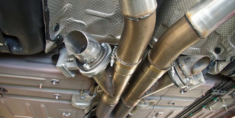

Thanks for the reply! Unfortunately, I am looking to keep the mufflers (for highway cruising withou any drone), but want to have the option of "bypassing" them when wanting a more aggressive sound (like the stock NPP system, or the B&B 'Fusion' system that has a vaccuum actuator). My thought was to keep the MF x-pipe & install an axle back bi-mode muffler system. My other thought is to install some electric cut-outs on the current system & not worry about putting new mufflers on at all.

Electronic cutouts that dump before the mufflers would do what you are looking for, and should be the less costly of the 2 options.
Something like this:
We actually sell the Y section for this type of application. The one that would match the piping of your street catback would be part #10784
