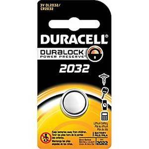

Also, change out the batteries in your FOB's just to be sure that that is not the issue.
