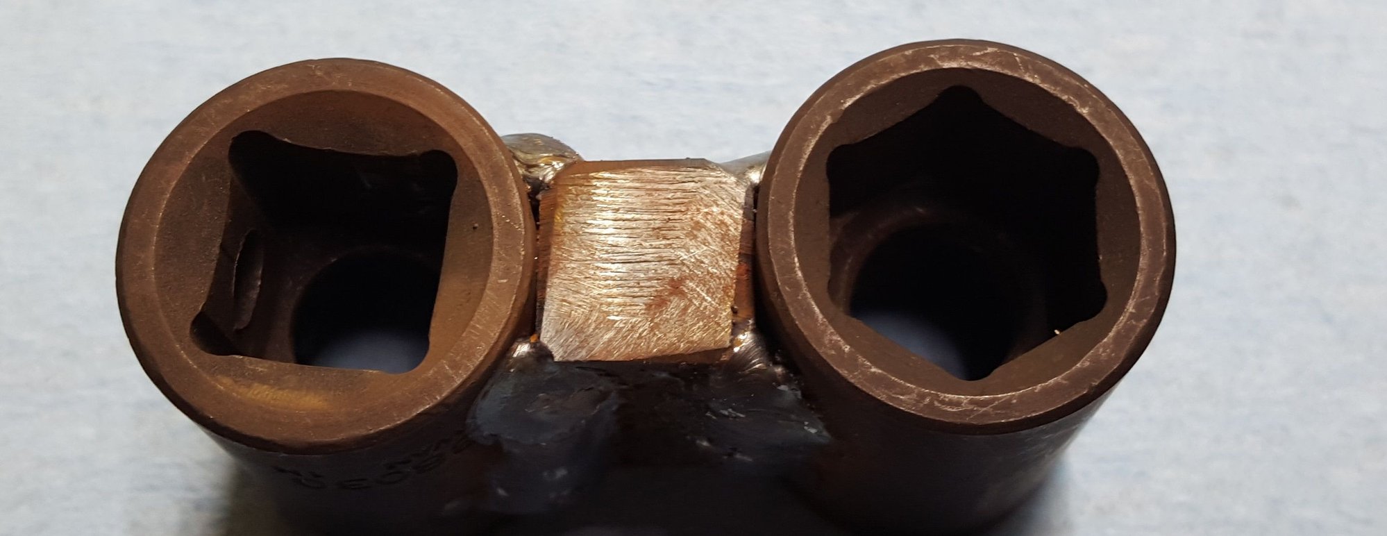

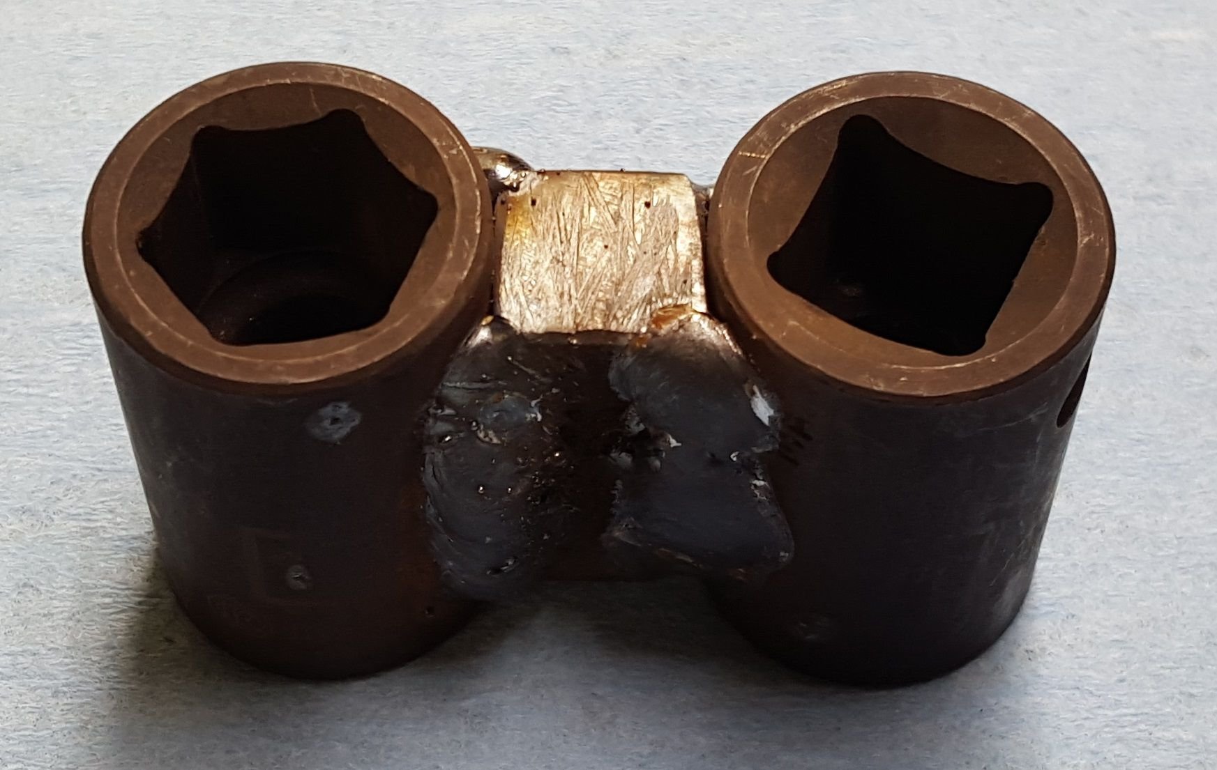

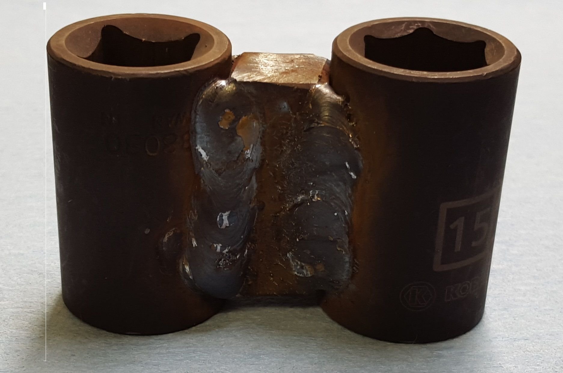

For me the two on the outside of the cat/manifold were the tough ones, till I made this. Its two 15mm sockets welded together flip flopped and turned a bit out of sync. From the top with a long extension and one or two turns and it was loose. I did leave one in that was easy to get at from underneath.
I pulled my starter to drain the block before I removed the heads.
