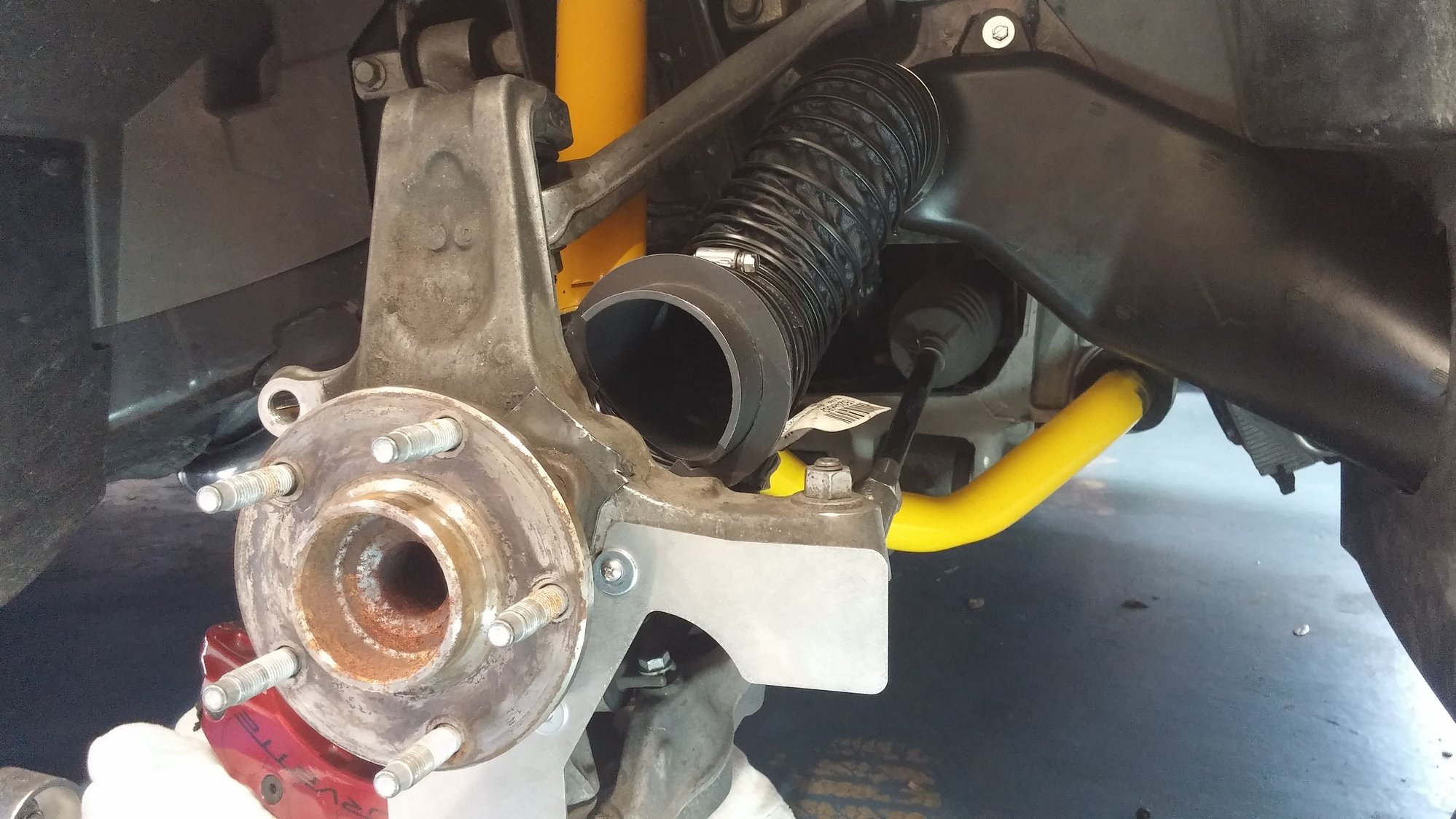

Build a brake cooling kit from Lambert. This makes a huge difference. I just completed mine yesterday and have about 200 bucks in it.
Then add Racing Brake rotors. Whatever rotors you get, do not get rotors that are drilled, that is where the stress fractures primarily initiate from. Problems solved.

You do not have brake spindle ducts stock.

Ok thanks, do you have directions and or a kit on how I can add the ducting?
Old Mar 24, 2016 | 03:06 PM
Suns_PSD's Avatar
Suns_PSD
Joined: Oct 2012
Posts: 8,434
Likes: 411
From: Texas
http://www.lapponline.com/index.php?...cPath=89_90_99

Some clarification is in order, because you guys are talking past each other....
- A big brake kit (BBK) is how people refer to aftermarket setups like StopTech, Wilwood, etc. While the Z06/GS brakes are different and use larger rotors than the base cars, it's not a BBK per se'
- The GS like the Z06 has front and rear brake ducts
- The GS and the Z06 do not have front spindle ducts as mentioned above. LG, DRM, Lambert, and others sell spindle kits, all with pluses and minuses
Regarding the OP original question. Hairline fractures are no big deal. Replace the rotors when the fractures extend to the edge of the rotor.
My rotor consumption decreased when I added the spindle ducts and hose from the factory ducts to the spindle ducts, so yes it matters and makes a difference. Lots of threads on this with pics.

I'd go 12/10 on the pads. The fronts do most of the work and in my opinion 12s on the rear is spending money for the sake of it.
Regarding the spindle ducts, the pros and cons revolve around installation and cooling. For instance, the LG ducts require you to remove the hub while the Lambert kit does not. The Lambert kit does not have as straight a shot to the rotor as the LG kit....ie the LG kit gets more cool air into the center of the rotor. The Lambert kit includes heat shields for the tie rod ends, the LG kit does not.

Thanks again. So it seems the LG ducts are better just harder to install.

Yes and no. I don't believe the LG ducts have the heat shields for the tie rod ends. The ends can be wrapped however. From an airflow perspective, I and others are of the opinion the LG design is better. Again, just opinion on my part.
