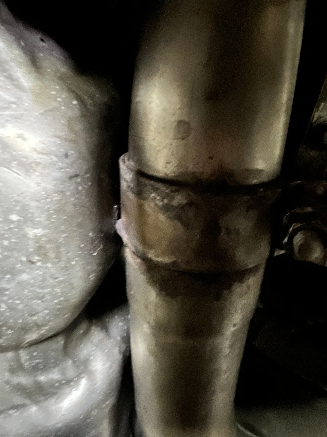

I just installed the Borla S type and I am having an issue with clearance on the driver side heat shield. Has anyone else had this issue? I have used a bar to pry it away tighten everything up. But it wants to spring back. Any suggestions?

Bend the heat shield more. My muffler guy had to put some pressure on the shield to get clearance.

I thought about putting a little bend in the heat sheild..I could move the pipe fairly easy with a small bar it just wouldn't stay.
Ok so I used some tie down straps with all the bolts loose…….I held the mufflers in the center with one strap. I pulled the pipe away from the heat shield …..about a one inch gap. Then I tapped it with a rubber mallet. After tightening all the bolts ….then loosening the straps. It sprung back a little and I now have a half inch clearance.😄. Yeah……I am a happy guy. Oh… and the exhaust sounds awesome! Thanks guys just one more option to try!
