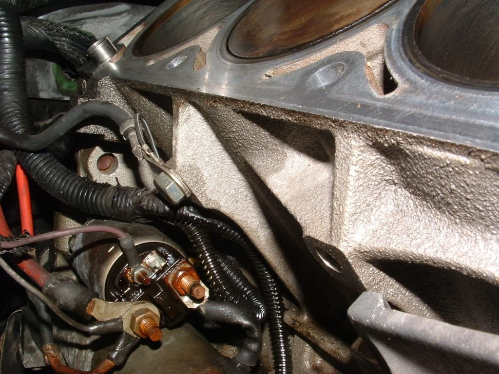

Finishing a rebuilt and is connecting the starter engine cables (which should have been done earlier because now its tight). A got unsure how to connect them as it is hard to se. Do anyone have a picture? The large power is easy but there is a smaller one, where should it connect?
Although this is a C5 starter, it's the same connections for the C6 starter.
Schematic of C6 Starter-Solenoid

It differs from LS7. Mine have a connector for some wiring (would guess the starter signal etc). But I only have 2 cables on the plus side? Should there be three? Two also grounded to the block.
