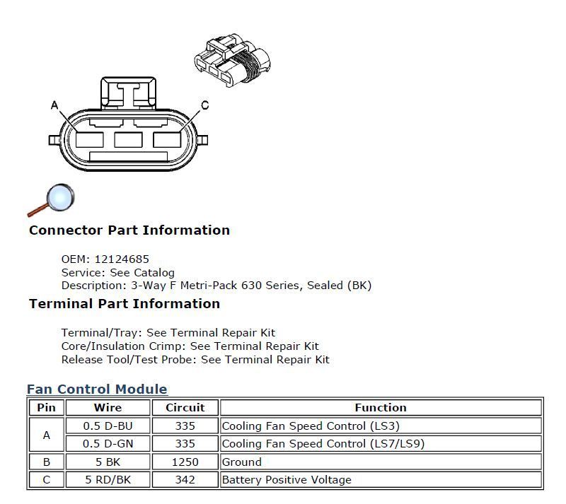

Old May 31, 2016 | 01:10 PM
schpenxel's Avatar
schpenxel
Joined: May 2004
Posts: 16,667
Likes: 1,209
From: Raleigh, NC
St. Jude Donor '15
Connector info

You can buy the bare connector and keep the wire size the same. It sounds like you guys tried to use a pigtail instead, which probably did come with smaller wiring.
Regardless... that connector is obviously being pushed to it's limit, so a better solution is probably not a bad idea anyways if you're having issues
