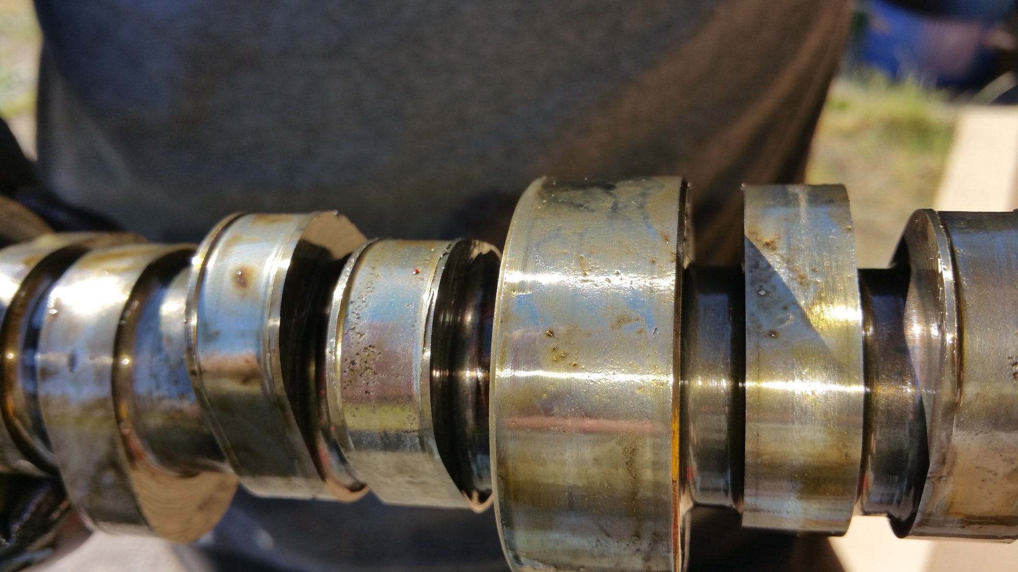

Heard very faint, intermittent ticking for a couple weeks. Thought maybe it was a rock in the tire or something since it was quiet, and didn't seem very consistent. Then 0 oil pressure. Pulled the heads/cam/lifters and found pretty much the same issue. Pitting on a few lifters, and a weird groove worn into the cam...
4-5 lifters had pitting like this, and the corresponding cam lobes were grooved.
You can see the grooves on a couple lobes here... My gloves were also dirty so a lot of the grit on the cam was from me...
At this point - I think I may just pull the engine, and rebuild it myself. I was considering tearing it down, and going w/ a 404 stroker kit for the rebuild...

It would allow the lifter to "bounce" and once you get a single chip in the lifter it will lead to more bouncing and more chips. This is the best explanation for this I can think of.
There's also the possibility that the cam surface wasn't perfectly smooth/polished and that some chatter marks were left from machining and just finally wore to failure.

Changing springs in your case is a must however imo that lifter failed.

it wouldn't matter how you drove the car.the spring your using is a severe duty valve spring that is hard on the valvetrain.you were likely floating the valve train and that caused the lifters to lose contact with the camshaft which in turn caused all the damage. that heavy of a spring would need to be checked on a regular basis.report back on spring pressure's when you get them checked.even if you hadn't floated the valves thats a lot of spring pressure on a 65,000 mile street driven car regardless.I wouldn't expect the valvetrain to survive for that many miles.just my opinion
